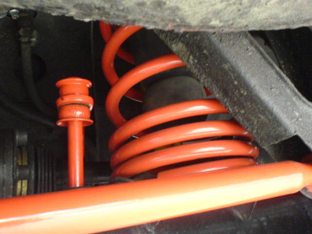

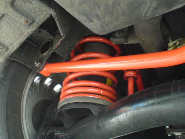

Kevin here are the pics of springs. I gave them my old springs to reproduce new ones. Afair they were around 40kg. Didn't want to go further with really soft front, and these will be here temporairly as soon as RSR system goes in :twisted:

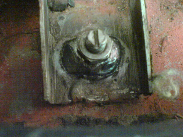

Few more. Umm after 2 days of racing, the transaxle snubber went through the tunnel inside the cabin :shock: Does it happen often, when car is sportily abused? Now under hard launches the guibo hits the tunnel :x
Re: GTV6 Zender
What is a snubber? Is it the rubber stop on the chassis pointed towards the transaxle? If that is the one, never seen that happen before. But there's always a first time :D

Yes, we are talking about the same thing. I found term "snubber" long time ago on Greg's page so I took it for granted :) Anyway, as far as first times are concerned, I hope my gtv6 has already depleted it's limit :lol:
Re: GTV6 Zender
Personally, I would go easy on the hard launches. Even on the start grid i never drop the clutch(mainly because I have to much grip on slicks). Once your gearbox mounts are drilled the gearbox wont 'jump about' as much and make the noise in the tunnel. When the GTV6 was first launched here in 1982, the Car test journalist made a note of this strange sound in the tunnel on a brand new car on hard pull offs so its definately not your car only.

Sorry for sluggerish reply - Kevin i have removed the bolts from the mounts due to increased vibration - i'll adress that later - must be inbalanced or bent driveshaft.
This should do it I guess as far as snubber is concerned:
And, No, the nut is not welded to the chassis, just the bracket ;P
