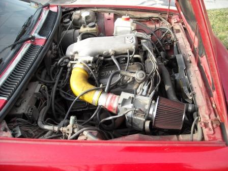

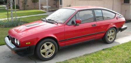

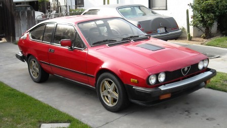

i'm gonna try to post a pic of mine
Re: New to Alfas and GTV6's
i hope i can figgure this out
that worked....lets try another
