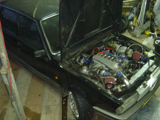

- engine bay
- Giuliettaupperlook131104.jpg (54.51 KiB) Viewed 18327 times

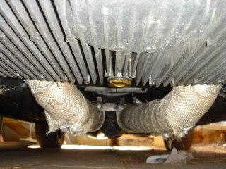

- GiuliettaTwinDownpipes.JPG (19.93 KiB) Viewed 18261 times

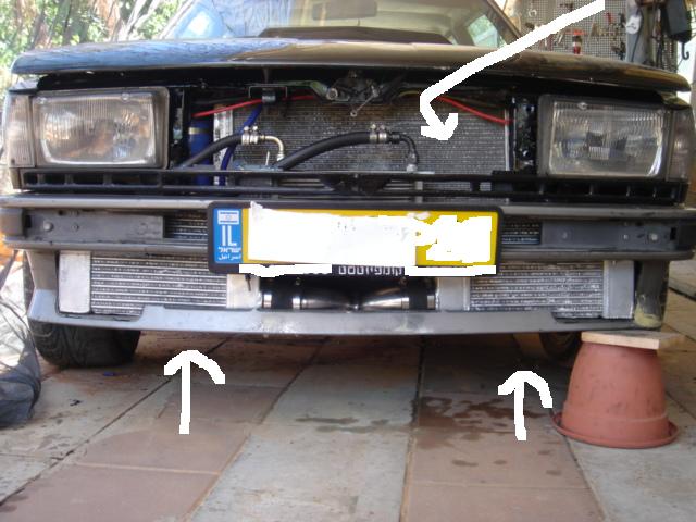

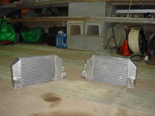

The front air and oil coolers setup, after the last heads work and bolts retorque I was bit worried about the whole cooling system so I replaced the water rad to a DAF City series trucks radiator with great very solid core and welded on huge costum tanks.
Lots of people said the coolers should not be positioned low , So I ran some tests with 3 different positions for an additional air temp sensor on the coolers (they have special screwing -hole ) ,connected to the Haltech's input , at 14psi on a day 27*c the boosted air did not heat beyoned 40*c without a water\Meth injection .
- NewFront_GiuliettaTT1704.JPG (50.88 KiB) Viewed 18271 times

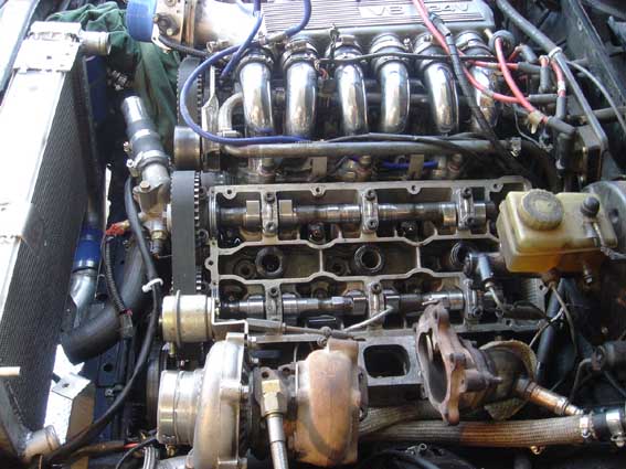

other parts in the engine bay:
- Car has power steering and heating working(BMW 528 Pump and 75M rack), I'm thinking of installing A\C later on this year.
- Cooling_system 003.jpg (90.08 KiB) Viewed 18255 times
- I have to give all the credits deserved to the folks from Glenwoood , the manifold they made is brilliant, it was nicely designed from 164S Plenum lefties, in e a shape very similar to most turbocharged supercars that use this tringle design .
I had to - PortedManifoldAlfa 001.jpg (66.61 KiB) Viewed 18257 times

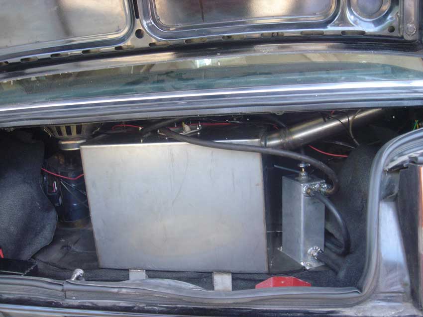

- SS Fuel tank in the trunk with surge tank to avoid pressure- drop on the two outer fuel pumps .
- Giulietta Fuel Tank relocation 001.jpg (69.61 KiB) Viewed 18239 times

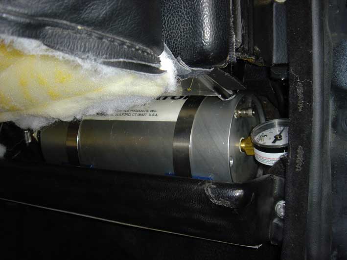

- That's an acumilator that releases pressure into the oil system to feed the turbo's on start-ups and harsh situations.

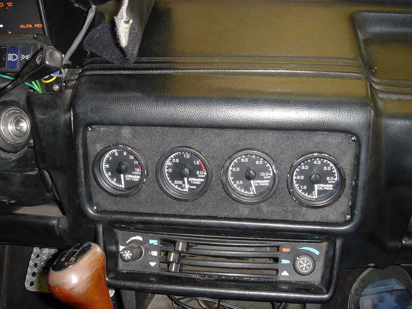

- "Hey' officer , these are the stock gauges,can't you see it's a Japanese car???" :)
- DSC00390.JPG (107.71 KiB) Viewed 18241 times

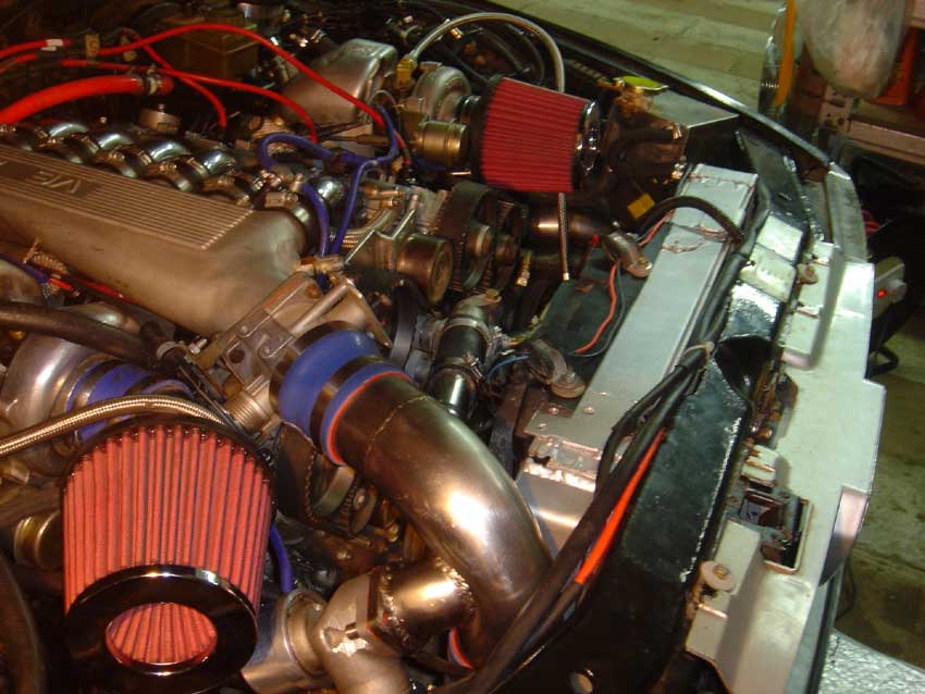

I'm considering to go single turbo soon , probably with a HX\50 Holset or a GT40 Garrett turbo , I have allthe parts needed but the nmanifold which is a bit of a problem to design for efficient gains (especialy with the big diveded turbine housings of the large singles . the main thing that bothers me about the Twins is all the extra-everything (exhausts ,Westgates , leaks and pressure balances).
