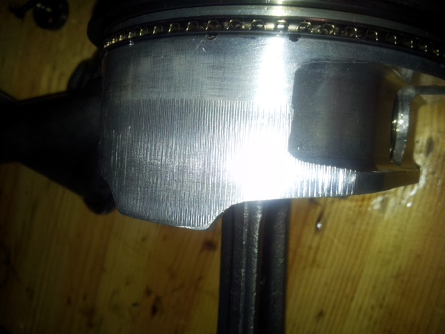

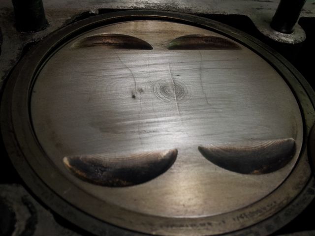

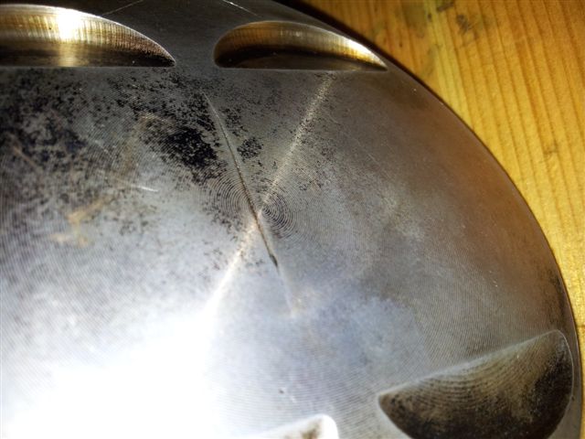

my mechanic took the entire engine apart and my pistons are all cracked.
the crankshaft and block is okay but pistons are broken.
i am going to sell this block and put a gta block in it.

I guess detonation was pretty bad, do you have any info on what ignition timing and air fuel ratios you were using in the ECU map? what ECU are you using?

there were no signs of detonation after the last gasket, i have an autronic ecu with max 30° pre ignition.
i will put pictures as soon as i have them.
AFR is between 14 and 12.5 at acceleration, that should be fine.
Re: introducing myself
I have a 33 16v with a modified engine (porting and cams), Max advance at full throttle was 24º at 7600 rpm's, 30º seems too much for me. Do you know of any other V6's built to your spec? maybe something wrong with the piston's design or material? If Barry built this engine he probably has built an engine to your specs before, see if there was any failure of that kind in those engines.

Cracked pistons :shock: sorry to hear .
My sub assembly and RZ were built same time at same engineering and so far still no issues with mine under really hard racing . My advantage is I had mine mapped perfectly from the start and my team mate in our trofeo racing is the guy who wrote the software . Also my compression was 10.5 to1. Not sure what yours is .
I think the hardest part of any engine transplant is having access to someone who can map properly .
In my past (1998 - 2000) I broke three twin turbo 12v motors from bad ignition timing . All had cracked skirts until I finally found some one to map the engine properly and lock in fuel and ignition parameters that would not create problems .

It does ring to mind bad ignition timing, per the failures marc said.
Mapping definetely is everything, always start with conservative ignition timing...

pistonskirt
