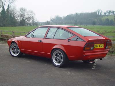

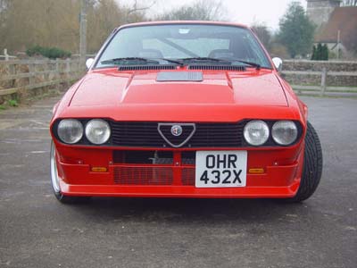

Howdy. Thought you might be interested in some details of the restoration of my GTV6. The work was done by Alex Jupe and you'll find photos on his website at:
http://www.alexjupemotorsport.co.uk/g07/index.htm
and
http://www.alexjupemotorsport.co.uk/downloads.htm

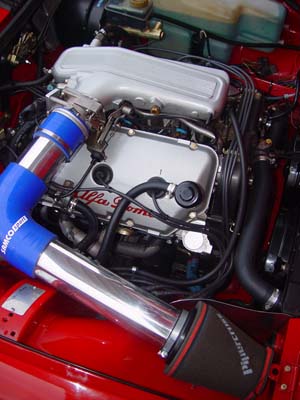

Engine is a Glenwood Motors 3.5 litre, 12 valve V6 with a Gotech engine management system. The rolling road measured 228 BHP/248 FT LB torque at the wheels. It has a 75 Twin Spark gearbox (with LSD), RS Racing suspension kit with poly bushes and SZ A-frame bush, Brembo brakes up front and SZ calipers/vented disks at the rear.
CSC exhaust with ANSA back box sounds fantastic. It howls like an animal above 3000 RPM then crackles like a Boxer engine with carbs on the overrun. :D

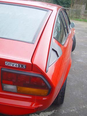

A few more pics:

Nice to meet a fellow Glenwood 3,5 12V owner.I had the same mags on my previous GTV6 and am now deeply regretfull that I didn't keep them. :cry:
Your GTV6 looks stunning.My 3,5 also pops and bangs on the overun but your right,open the taps and it just sings through to 6500rpms.

your car looks fabulous!!nice work!!
Beatuiful... *thumbs up*
Gotta love that 3.5 emblem... :D

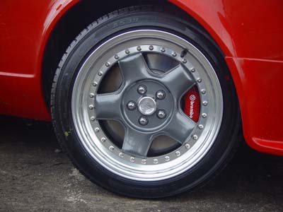

So what are those wheels and what size are they ? They look to be about 16" in diameter, but can't tell what the width is.
Merril
82 GTV6 3.0
Plastic Pig
Posts: 46
Joined: Mon Nov 29, 2004 1:50 pm
Location: Sussex, England
Post by Plastic Pig »
Merril,
The wheels are three-piece, 16"x7" Compomotive RJs. They have been fitted with spacers, so probably look wider than they actually are.
I needed 16" rims to clear the Brembo brake calipers and 320mm dics.

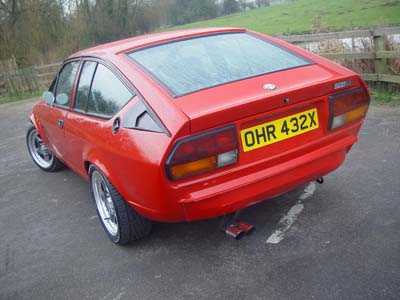

Here are some more pics that were taken during a track day at Castle Combe circuit recently. The car was brilliant :D , but it needs a better driver :oops: .
