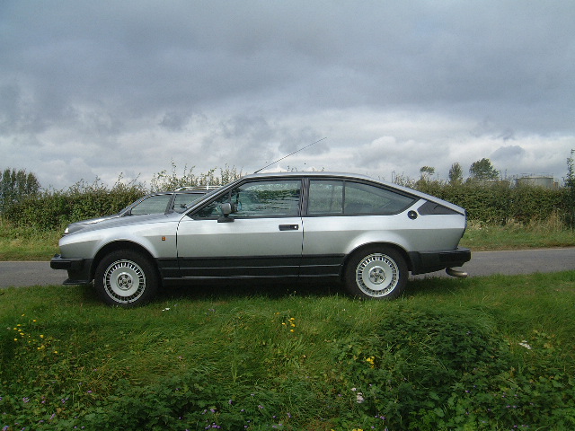

Older GTV is all original with no restoration apart from new exhaust (original type), Koni dampers, new tyres (original size) and normal servicing parts. Paint is original and the only rust is a tiny bit at the bottom of the rear window and a small bit on a side door. It drives like new and should do since it only has done 18000m (28,800km).
