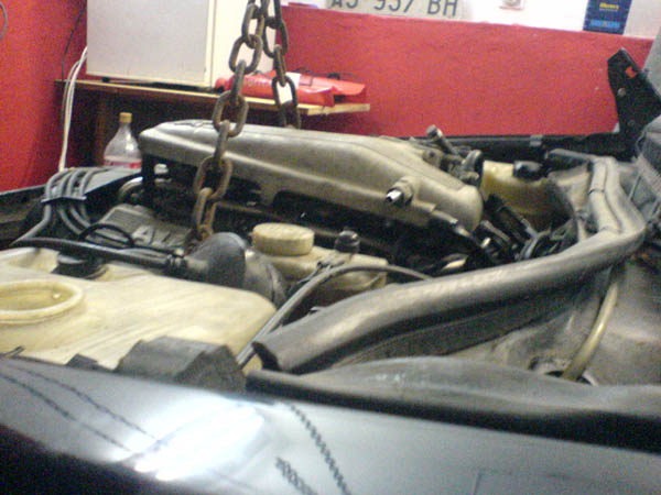

Few updates from November. Engine and gearbox removed, car will be transfered to tinsmith since there are some weak spots under car...
Meanwhile I'm looking in options either to buy 24v 3.0 or to bolt turbo charger on 3.0 12v.
Still there are lot of things to do; shorter gearbox 10/43 will be packed into v6 housing, plus lots of bits are ordered like new (std) brakes, pads, bushings etc...

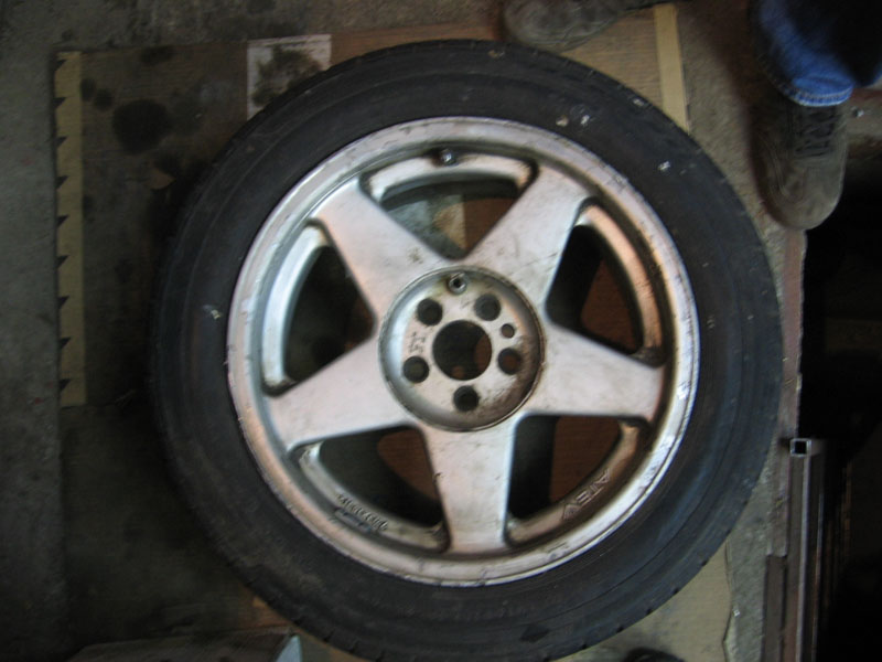

Lots of work regarding to almost destroyed wheels (16' 7.5J ET 30), sanding to the metal, filling, sanding, painting...
New parts arrived also...

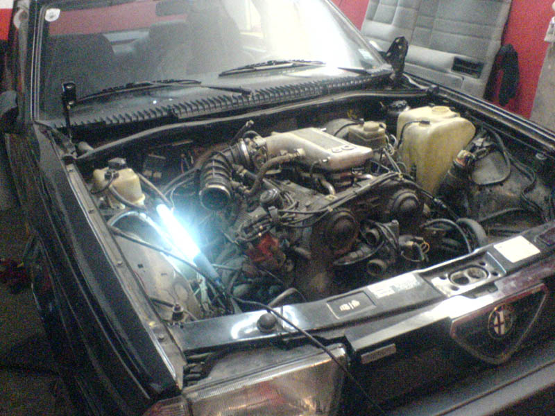

I had second toughts for 3.0 24v (costs would be pretty high), so I've found one engine from AR 164 and it is 2.0 V6 Turbo. This might be unique conversion - haven't saw any 75 V6 2.0 TB. :lol:
Still lot of work to do, but weather is getting better and mood also. :)
