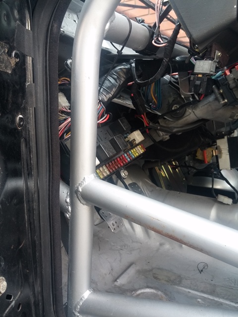

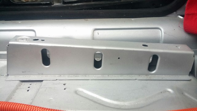

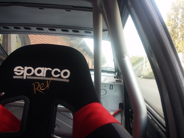

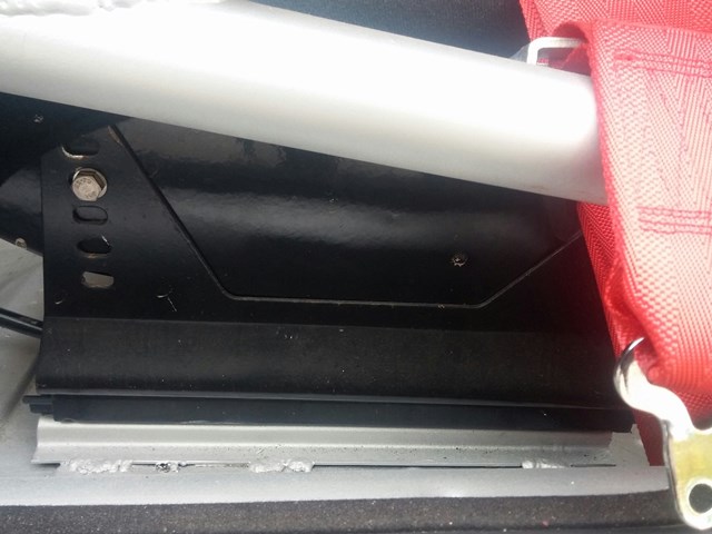

Hi , it's a shame all your images have gone as was just going back through topic and looking for your suspension pics . Can you post some more of roll cage . I'm interested to see how far back you have the main roll hoop , ie how far is it from the chassis crossmember over the tunnel . I guess it also depends if you're running pedal box ( your case not ) and what type of seat . Currently planning a build of a 75 race car and must suit second driver who is 6.3 ft hence the interst :)

I'll snap some pictures of your interest. I've moved main hoop backwards to have more space for legs and maybe in future pedal box - also seat "ears" where close. Note that you will have to cut out seat stands since they are to high. I'm 186 cm tall and I had issues while using helmet.
More details soon...

Sorry for waiting, few pics and comments...
Seat & shoulders clear
Main hoop position
Main hoop position
Original seat stand (too high)
Lower seat stand...
Lower seat stand...
