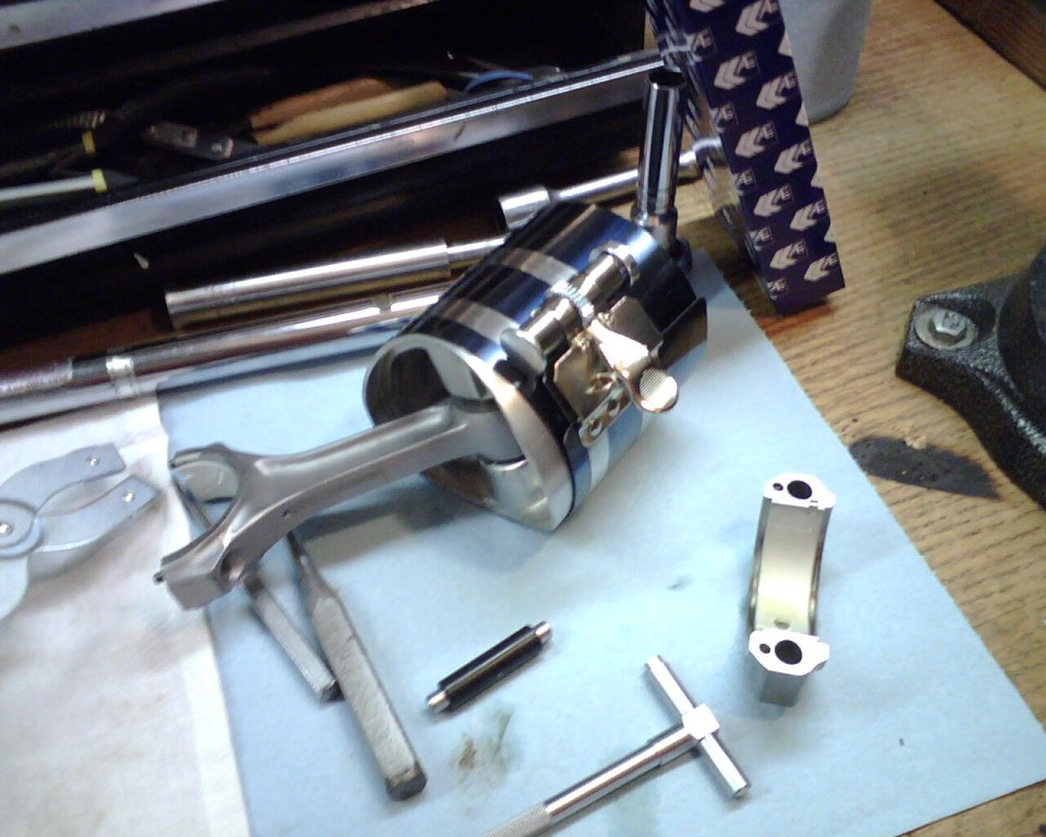

Polished and shot peened rod on piston.jpg (117.8 KiB) Viewed 2677 times

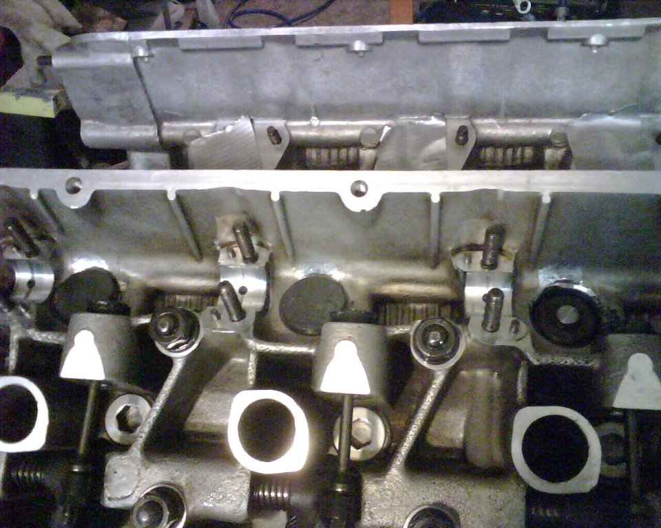

The shiney spots next to the intake tappets are where I made some clearance.
needed some clearance for the intake lobes.jpg (155.11 KiB) Viewed 2677 times

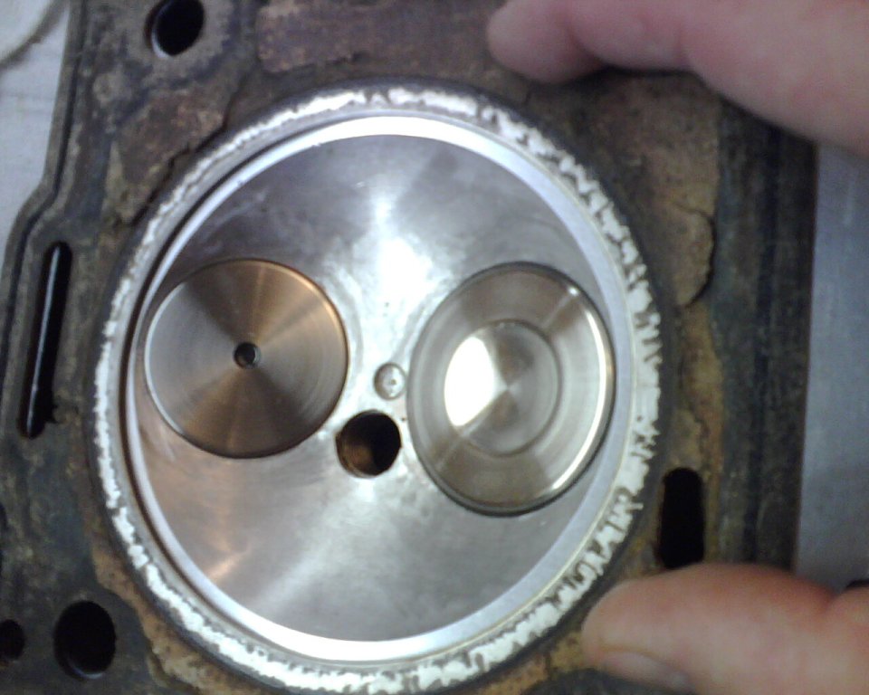

The old gaskets that I used for the mock ups are cleaner and less flakey than they look.....:)
Heads are cut 60 thou used cleaned old gaskets for checking p-v clearance.jpg (100.84 KiB) Viewed 2677 times

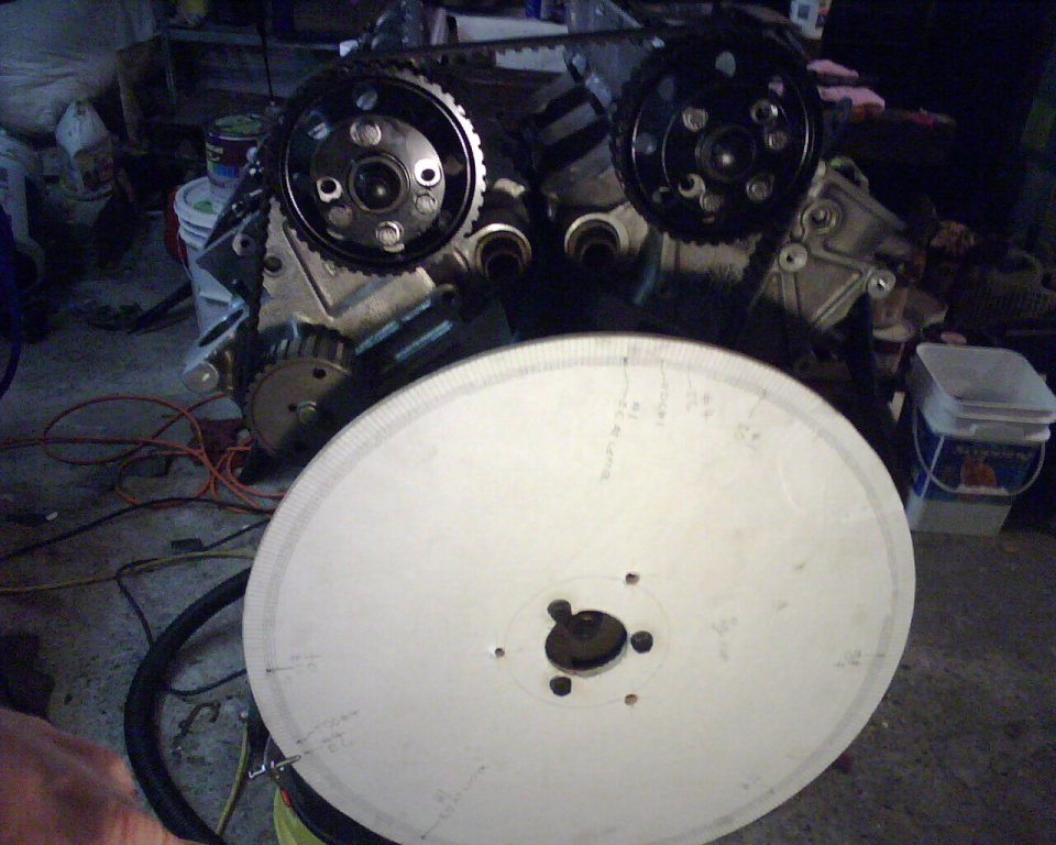

This is my home made 18" degree wheel, you can also see the adjustable cam sprockets.
degree wheel.jpg (118.93 KiB) Viewed 2677 times

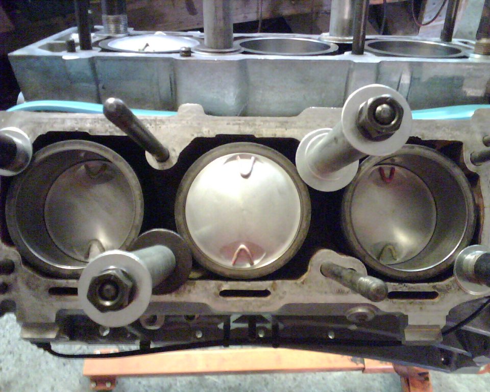

the v-shaped thingys are clay.
checking piston to valve clearance with enlarged pockets.jpg (147.34 KiB) Viewed 2679 times
