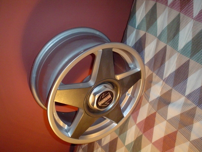

I have now finished with the wheels. I had the dings repaired and now they are painted. They are 15/7/et38. I painted them a little differently than they had been painted originally (all silver). I am very excited about the prospect of mounting up some nice wide rubber and going around corners extra fast with them. I think with the charcoal star they will be more low key than all silver, plus they wont attract too much small town police attention to my machine as they are (only) 15s.
