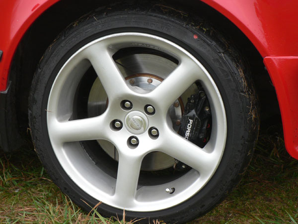

Since I started using my GTV6 on the track, I found it to be extremely well suited to that use with the big exception being the brakes. The first few laps were usually great, but then they would invariably start fading. This problem was accentuated when I improved the handling (discussed later) and installed a 3 liter engine. It was clear that the weak link in the chain was the braking system (well, if we exclude the driver from the equation
). I tried all sorts of things to remedy the problem like slotted disks/rotors, exotic pads and high temp racing brake fluid, but never solved the problem entirely. I suppose it is also possible that I as the driver uses the brakes too much since I know other GTV6/Milano drivers who do not have any problems. Anyway, I decided to use the 'brute force' approach to solving the problem by installing custom disks with a custom bracket in order to install Porsche 944 Turbo brake calipers (really just 4 pot Brembo calipers). I happen to own such a Turbo too which is one of the reasons I decided to use this type of disk. I was lucky enough to find a lightly used pair of calipers for a reasonable cost that you see on the car now. The installation had to be done somewhat hastily, so I have not yet had a chance to repaint them (at which point, I'll be able to remove the 'Porsche' embossed lettering
The adapter brackets allow one to bolt the (much) larger calipers to the Alfa spindles. The entire 'kit' was designed and built by Larry Jr. at Alfa Parts Exchange and I can enthusiastically recommend it. http://www.apedirect.com/
The wheels are 16" MAS MGR ... not terribly well suited to track use since they are pretty heavy. I'll be looking for some (light) track wheels this winter.
Pads are SBS Carbon Ceramic pads - actually made for endurance racing. One of the advantages of the 944 Turbo calipers is that there are lots and lots of pads to choose from. These are great pads. I've done 2 track events on them and they are not terribly worn either. Wor fine on the streets too.
The rear brake setup is from the SZ Zagato. Stock Alfa calipers, with an aluminium spacer to allow fitment of SZ Zagato vented disks. Easy installation and they have performed very well too.
The master cylinder is stock GTV6 but I will likely install a replacement from a 164 since I understand that this improves the pedal feel a bit. This is not a high priority since the brakes work perfectly well as they are. I could also install a bias valve so that the braking effort is vectored more towards the front of the car.

Here you can see the bracket assembly (I painted it yellow). I was able to retain the use of the original metal shield, and even the Alfa hard brake pipe which I re-bent using a brake pipe bending tool. Those stainless steel braided hoses are ones I've had on for years.
I did have to switch the balance pipes on the caliper from top to bottom since the Alfa has the caliper mounted on the leading edge of the brakes and the bleed nipple obviously needs to be on top in order to bleed the brakes.
