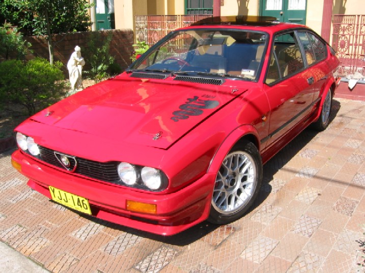

Here we go...
Ensemble 005.jpg (128.51 KiB) Viewed 14351 times

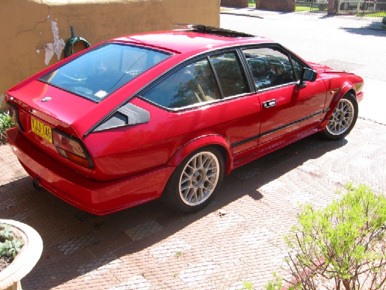

And....
Ensemble 007.jpg (140.7 KiB) Viewed 14349 times
Most of you will know, but yeah, she was a 2.0, now an 11+:1 2.5 with big heads and cams, making around 200hp @ the wheels, and FINALLY with a 4.3:1 diff on hte back of a 75 3.0 box...
