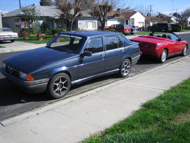

Here's a sad pic of my car. it needs a new coat of paint and the wheels cleaned :D
Z,Is this taken in the states?Where does the new spider come from?
Italy?
(sry, couldn't help myself)
A Buick, SUV, Caddy, curbs, blue license plate, must be California. I wonder about that spider though....
That's not a spider.... its a .... a..... a boxster :)
