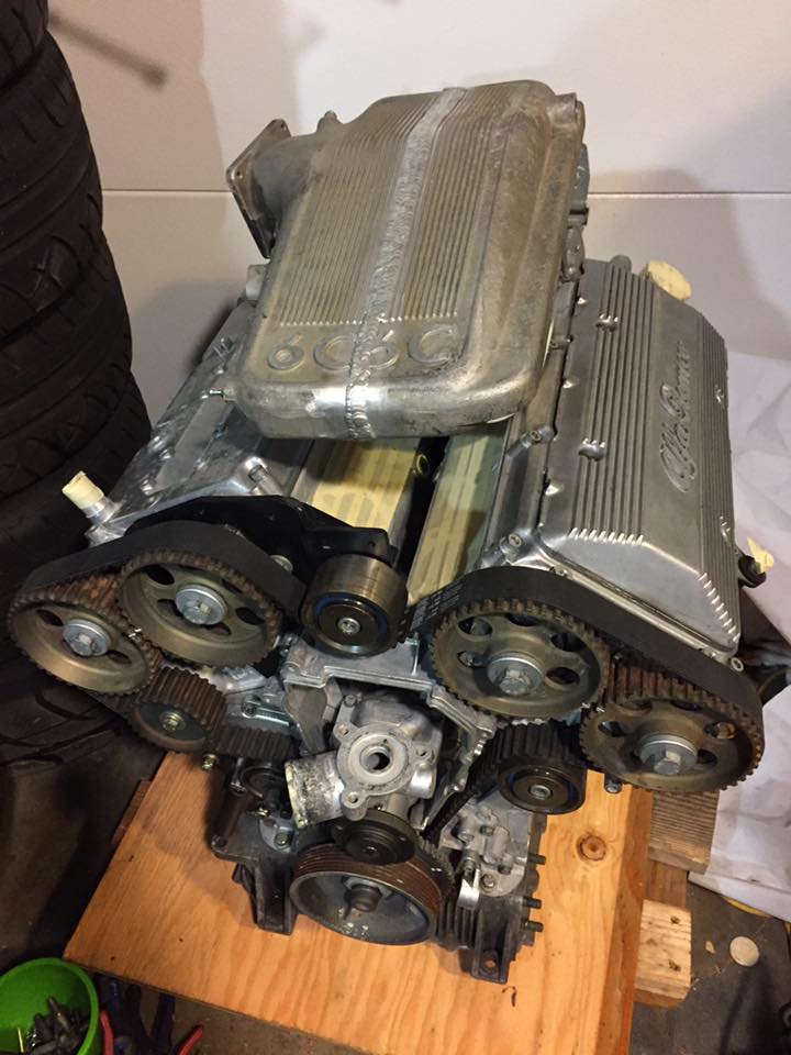

Finally my 3.2 is ready.
Re: Zamani
Does your welder use your plenum to learn how to weld? And what's with the 6C6C thing? Grind them off! If you do something make it look good!

Yeah, I don't think he is that good of a welder, but I can easily mill it off together with the 6C. It's not done yet. The bottom of the plenum is still not done. I still need to clean the cam covers, etc. But mechanically, it's almost there. Just need to find the correct alternator for it.

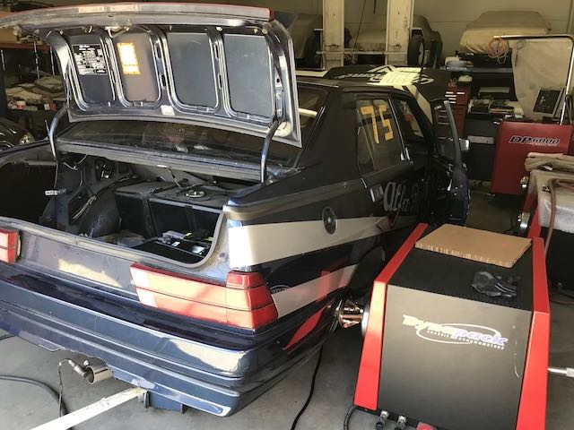

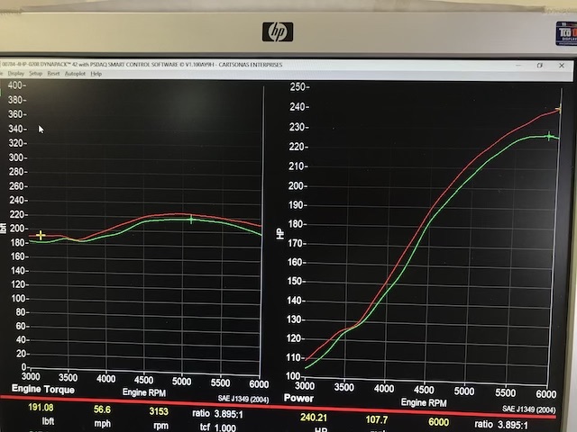

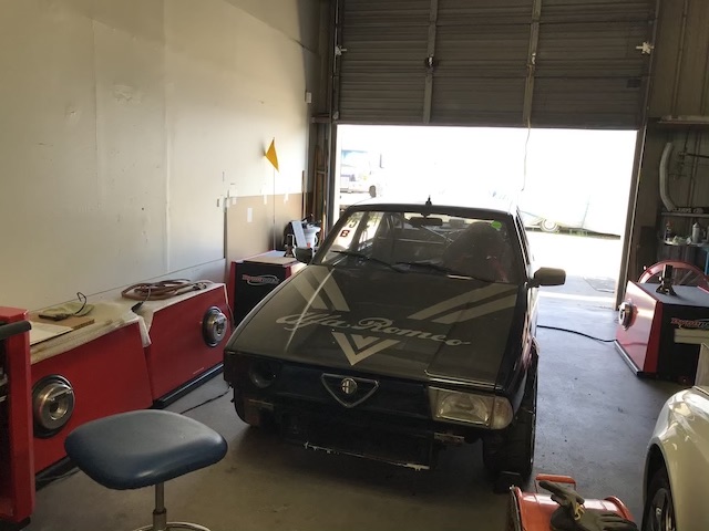

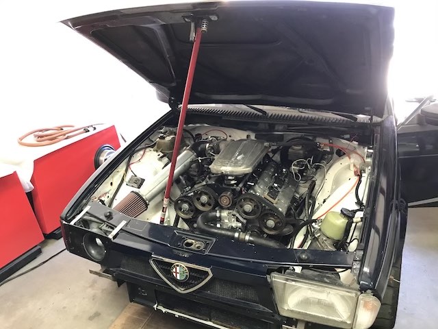

At the dyno
