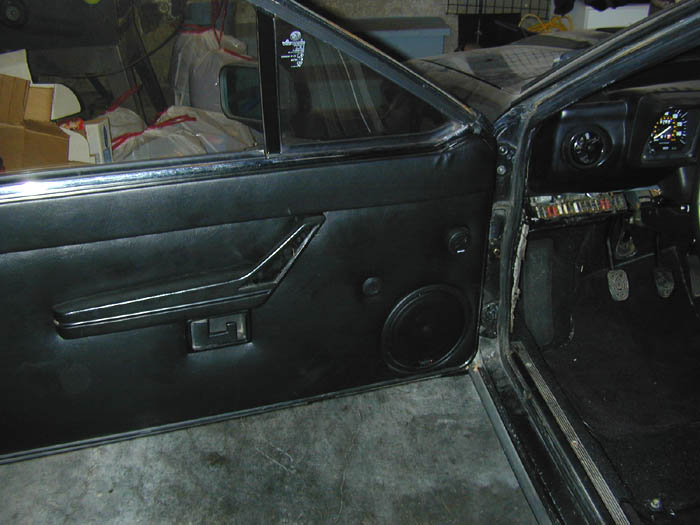

When I redid my door panel upholstry I cut some speaker holes and put a set of 6.5 inch component speakers (MB Quart) in there. Came out really nicely and the sound is awesome.
If you were going to do it with the stock upholstry on there, I would just suggest being very careful to plan ahead for the hole and where you're going to cut.

- DSCN0052.JPG (63.05 KiB) Viewed 16962 times

That actually happened to me, but I patched the old holes when I redid the upholstry. I used some thin composite board cut it to the shape of the hole and then used aluminum roof flashing and gorrilla glue to hold it in. So far it's worked extremely well. Once it was patched I then cut my own holes and did the finishing touches. The metal underneath wasn't in as good of shape though but I don't have the skill, tools, or know how to fix that.
