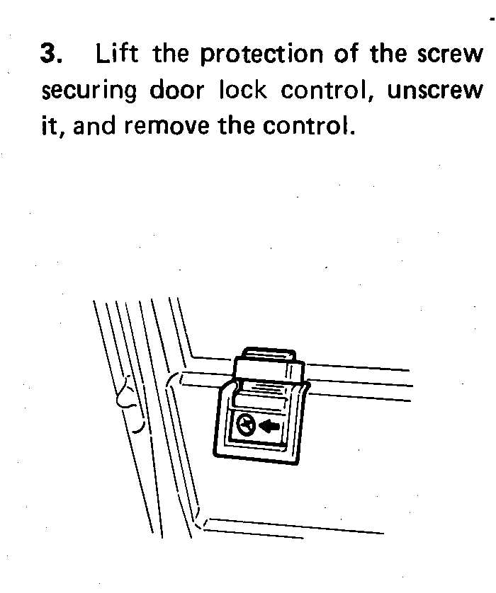

Could someone give me instructions on how to get the square door lock loose from the door panel? This car is very stock and I hate to break the lock trying to get the panel off. I need to replace the window regulator.
Thanks,
Meady (alfalfa)
Murray
Posts: 622
Post by Murray »
There are two models of door lock knob.The earlier version is held on with a a small philips head screw on the side and the later one is removed with an allen key nut which threads onto the lock rod from above.Both require you to open a fragile hinged cover...careful

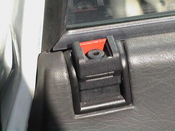

Thanks so much for the quick and detailed help. I have a 1988. Don't know if that is later or earlier. I had 1987 and it had the screws on the side and they were visible so maybe this one is the later kind on top. Do I pry the plastic off the top?
Meady
Murray
Posts: 622
Post by Murray »
Meady if you're dealing with the later design (top picture) the plastic cover is "hinged" on the lower inside.Mine was broken off hence the picture.Best way to pop it open is to use a small hooked tool of some kind and insert it on the window side of the knob and tug up .I'm sure those Alfa engineers probably had a special 3 piece cast iron tool designed to do this but a hook will work.
