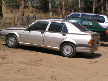

- My 75.JPG (32.61 KiB) Viewed 16943 times
Trunk

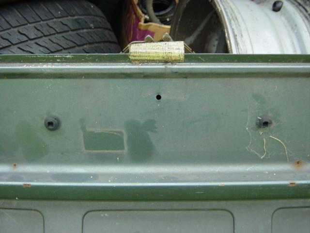

Matt,
You may have already have the boot open. Here are a few pics of the boot release and how to get in. Behind the number plate there is a hole in the centre toward the top. If you poke a screw driver straight in, it hits a plate near the release mechanism. If you angle the screwdriver down and to the left you can catch the release lever and open it in. Looking at the back of the car, the lever operates to the left.
See pics.
David
See pics.
David
- Inside View
- Boot release from inside.JPG (44.05 KiB) Viewed 16840 times
- Screwdriver through hole
- Screwdriver in hole.JPG (37.03 KiB) Viewed 16841 times
- Behind number plate.
- Number Plate panel.JPG (33.8 KiB) Viewed 16842 times
