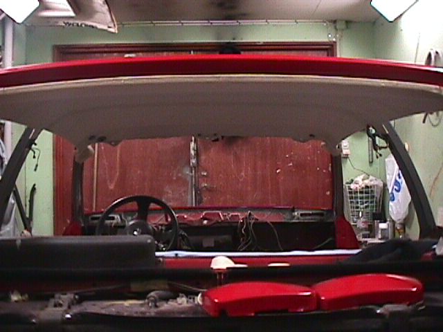

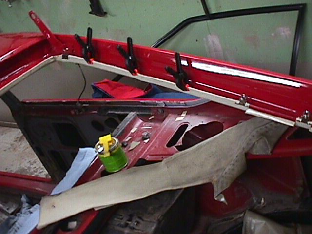

The headliner is glued all the way around. But if you´re careful I think you can remove/loosen it in the back to get an antenna in plase. Just take it easy so the headliner doesn´t tear, its getting old an dry if it´s the original.
Then use clamps to stretch it when you glue it back. Use contact glue. I put a whole new headliner in mine along with paint last fall.
Good Luck!
Seb
