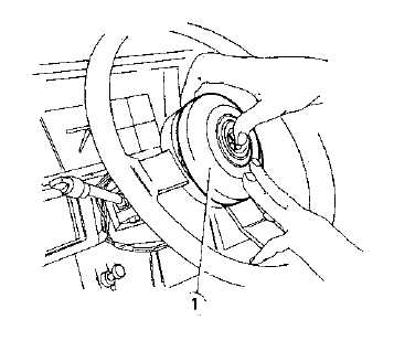

'85 GTV6, I have to change out the column switch and before I go and break anything, how do I get the horn pad off?

Don the horn pad just pops off.Press in at the bottom and pull out at the top as illustrated below.

- Hornpad.jpg (15.87 KiB) Viewed 5721 times
