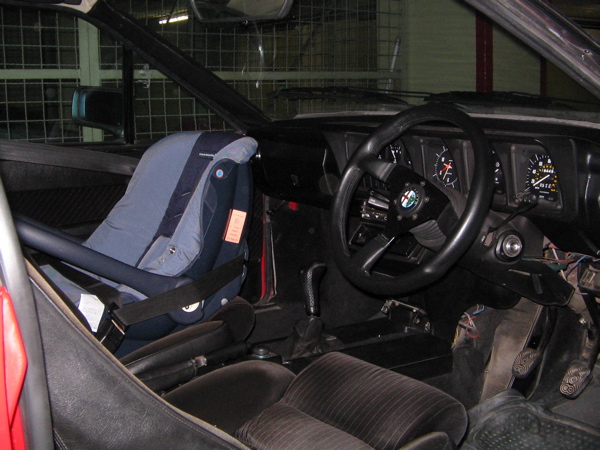

I just completed a 600 mile drive over the weekend with about 30% being in real tight switchback type of roads. Loads of fun for both me and my 4-year old.
I'm not sure what to tell you about mounting new-born seats. Seems when my wife, kid, and I all went together we took a different car then. When it was just me and the kid, I'd place his child seat backwords in the GTV6 front passenger seat as one normally would.
Now that he's older, he rides in a child seat that has it's own belts. My car's rear seats have (I believe) inirtia reals back there and were no good for spirited driving in the corners. I resolved the issue by removing the seat and bolting a new lap seat belt for a center location that did not have the inirtia feature. Just a simple seat belt. I then reinstalled the seat bottom with the new belt fed out just like the others. The rear seat center tray sticks up higher than the two sides (butt wells ?
but it hasen't been a problem as I just cinch the belt (fed through the back of the car seat) down very tightly. The kid seat doesn't rock at all.
Keep in mind that some kid seats are designed to use the car's lap and sholder belts. Unless it's a very modern car, those belts won't be installed in the center location.
Here's another observation; Anyone used to to get car sick when they were kids sitting back there down deep in the rear seat? Before child seats were a requirement we all just sat where ever. I used to get car sick and I think it was because I wasn't looking out that much. Probably playing with toys or something. Well my boy has yet to get car sick even though we terrorize plenty of fun back roads. I think it's because he's sitting up higher in his child seat and centered in the middle back there. He's got an unobstructed view forward and to the sides and as a result he's not getting motion sickness.
Of course, maybe he wouldn't get sick anyway and I'm all wet. Anyway, it's something I've thought about.
Hope that helps Simon.
Merril
