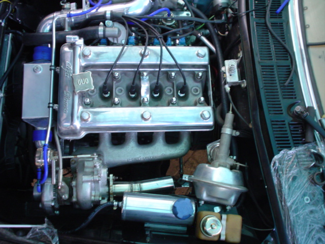

Your car was shipped to Alpine Developments by the factory here for the conversion.The engine was built with modified 20l Fiat cast pistons,7:1 cr.
Alpine fitted the cast manifold,blow thru carbs and locked the ign. advance at 25 deg.A malpassi rising rate fuel pressure regulator was used with an electric fuel pump from the Alfetta 159 motronic car.
The main jets need NOT be bigger than 145`s!! Probably find someone has reamed them to 200++ at some stage.
If the engine is good-(read blow by!! Your ring lands are probably broken.)-you will get reasonable consumption..if you dont use the turbo!!!!!!.
The engine is low cr slug,so thats already not good for consuption..
EFI is the way to go with a higher cr ..
Build your engine with 86mm Opel Superboss Mahle forgings.8.5:1 cr and theyre bullet proof.
A spider turbo I did-efi,good performance,good consuption when driven sensibly..Alpine manifold used.
