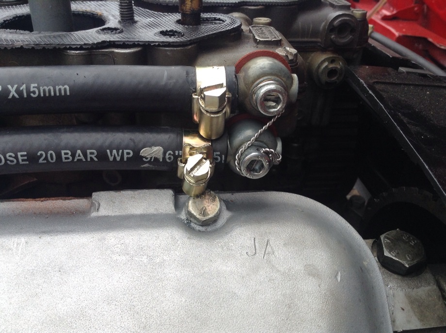

Thanks MD , I put in galv plated steel cap screws with a bit of anti seize . I only drilled the bolts one way for locking wire not two ways . I binned the stainless steel ones .
Then watched great youtube clip on learning the technique of locking wire from this link . Took about three tries until I was happy I got the tension right . Worth watching .
http://m.youtube.com/watch?v=OwFjUX6SaY8

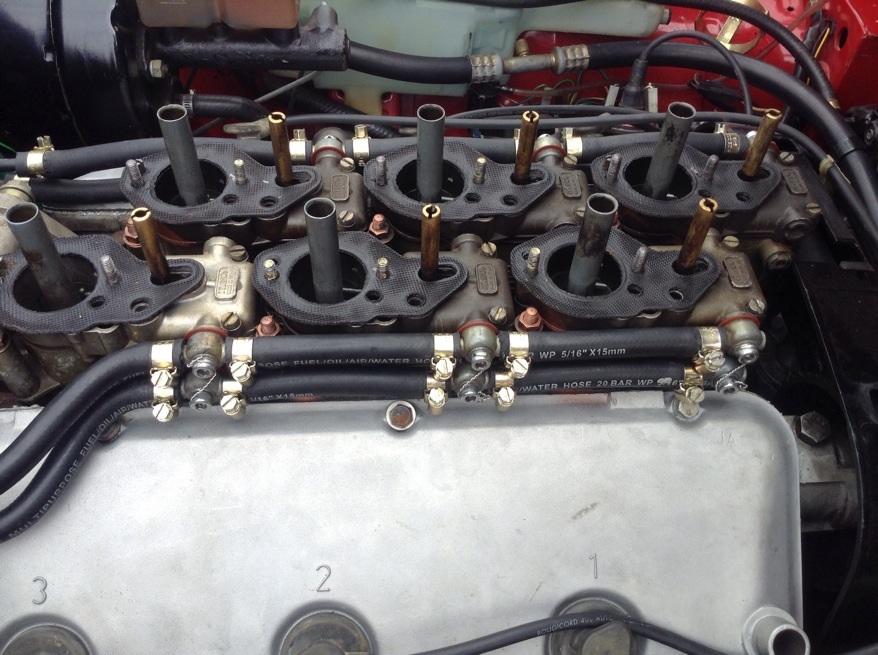

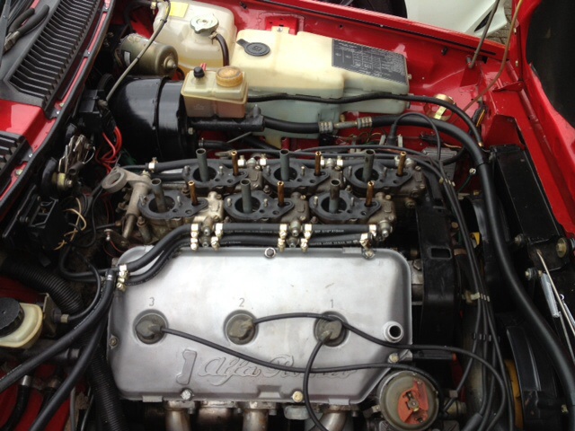

Some pics of job done and after a few best cyles all is good and no leaks .
- image.jpg (194.95 KiB) Viewed 6967 times
- image.jpg (212.99 KiB) Viewed 6967 times
- image.jpg (220.25 KiB) Viewed 6967 times
