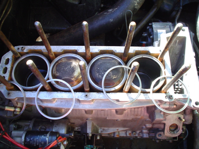

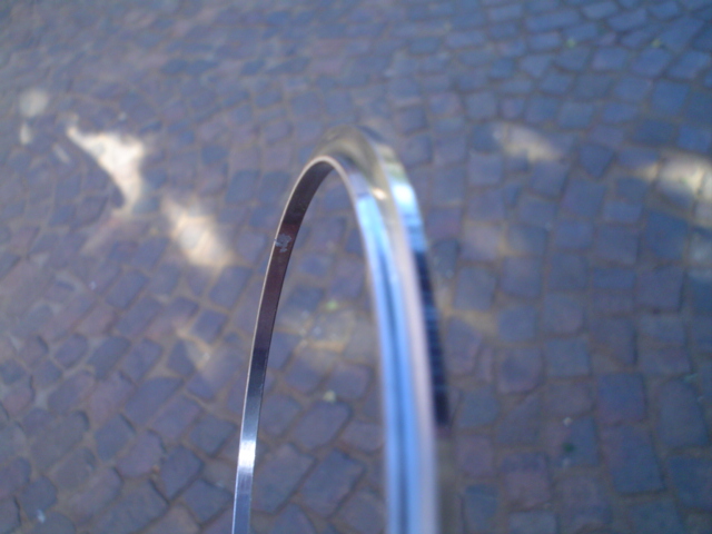

I machined reciever grooves in the sleeves for a stainless ring that is machined in an "L" shape.The pic says it all.
The "L" shaped groove protrudes through the copper gasket by 0.3mm.
This is designed so that the single groove or ridge can cut into the haed as its all torqued down.The ring is also 0.2mm thicker so it protrudes more that the Alfa sleeve protrusion spec.This is so it can clamp the copper gasket more vigiourisly..
The idea here is to have a twofold clamping effect.The first is the copper gasket being clamped in the normal fashion,ie: between the head and sleeve..Secondly,the ring or ridge that protrudes through the copper gasket and cuts into the head surface..

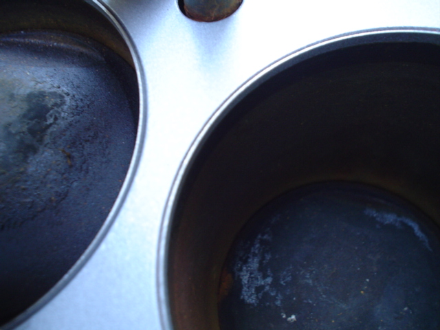

Here can be seen how well the clamping is between the head and sleeve..This is the copper gasket ,sprayed with ally paint..
Her the groove from the irdge can be seen
Protrusion of the ring ridge...
The "L" shaped stainless ring..
Reciever grooves in the sleeves..
