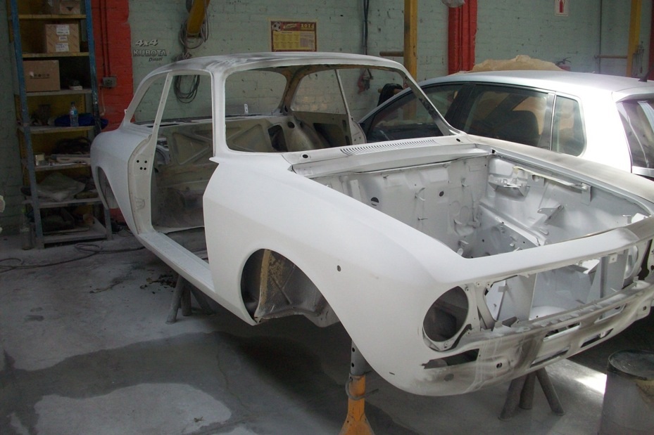

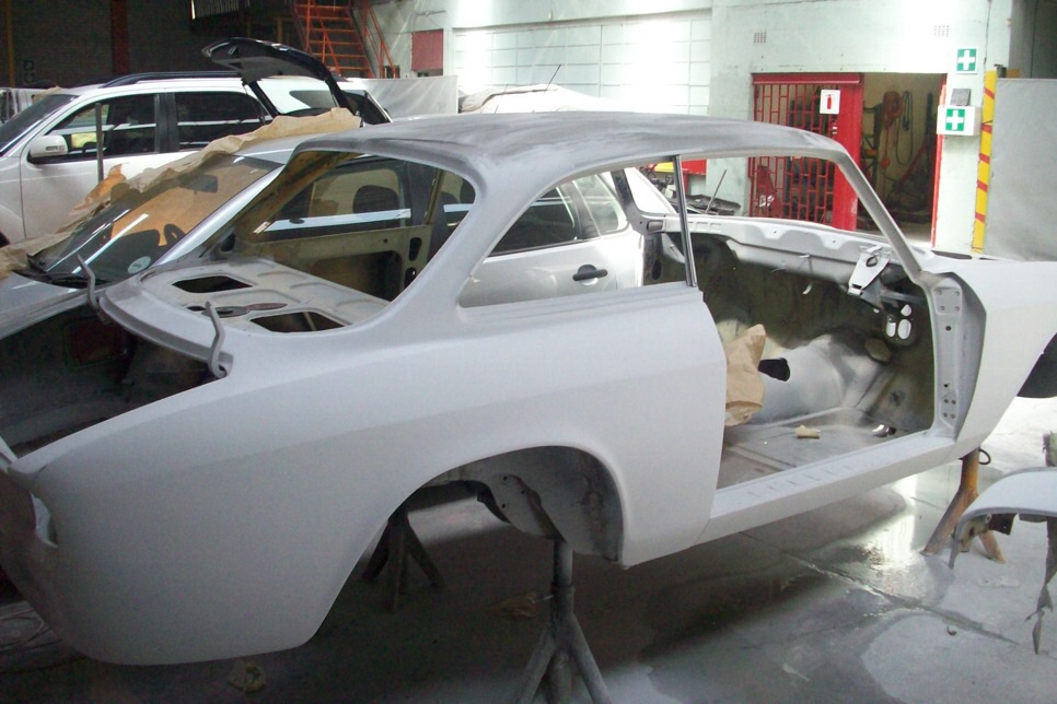

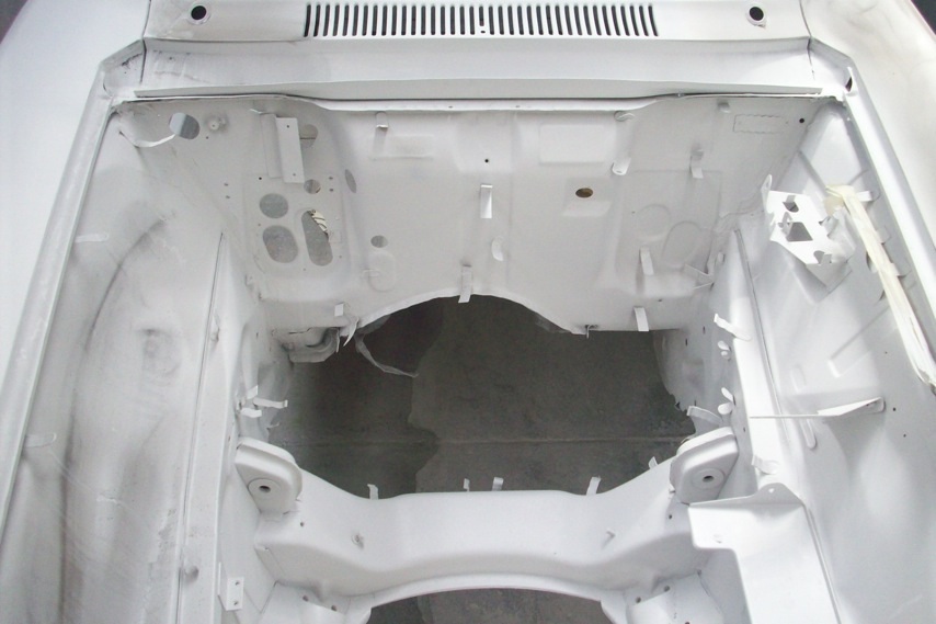

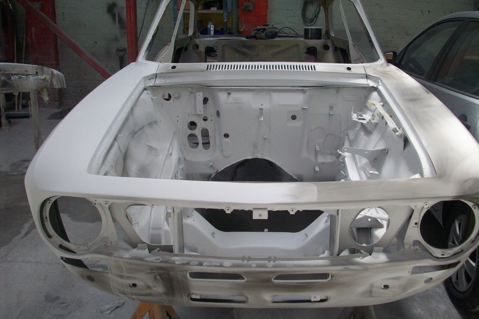

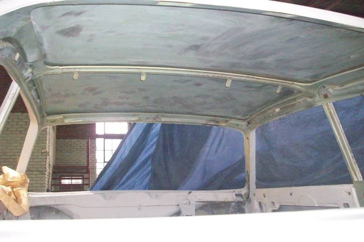

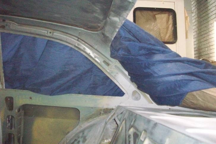

Some pics of my Junior in primer .

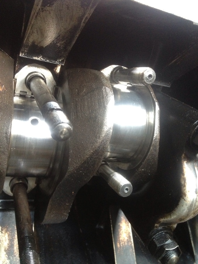

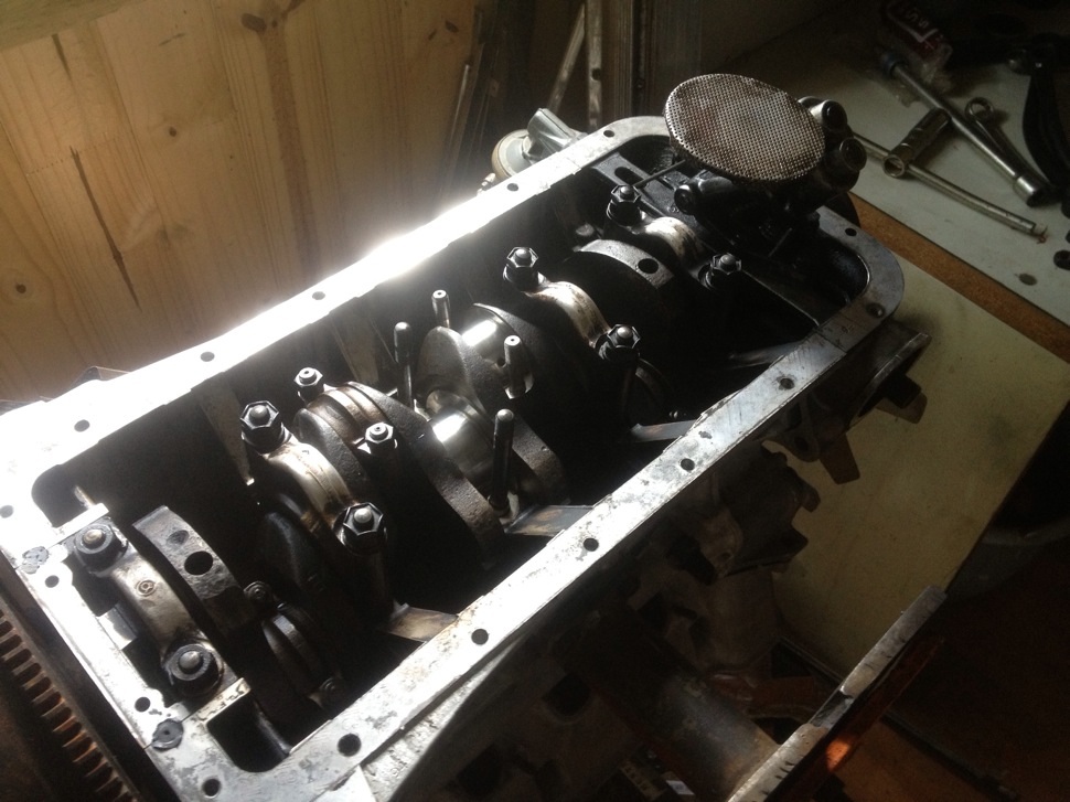

The engine in the car was really good so at this stage my dad and I felt it was unecessary to do a full rebuild and rather put the money into bodywork and mechanical parts that needed replacing or refurbishing . Also to just pull engine out is not a major job if we found issues in the future . However we still wanted a perfect drive to match its appearance so have had the gearbox redone with new synchros and seals , I changed the clutch unit with a brandnew Sachs unit from Classic Alfa which was ofcourse in my handheld luggage when going through OR tambo customs
Also bought all new hydraulic cylinders for the car z- brake , clutch .

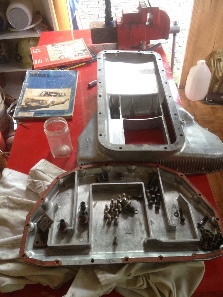

My dad removed the sump and cleaned any sludge which actually was vey minimal . We removed the bearing caps just to do an inspection and all looked actually better than "normal" . You can see light marks on journals but shells are immaculate , even cleaned out oil pump strainer . . We put in new sump and pan gaskets from AK , checked all the bolts threads put it back together .
The heads had been off this motor I assume not to long ago as they are much cleaner than rest of block and hence a clean burning engine . The water pump had zero play and turned perfectly . As I had no receipts of previous work done I assume it was also changed not to far back as it was also cleaner than surrounds - but once were up and running we can check again later . I know its a real sh1t to change once its all in but if it feels perfect then leave it .

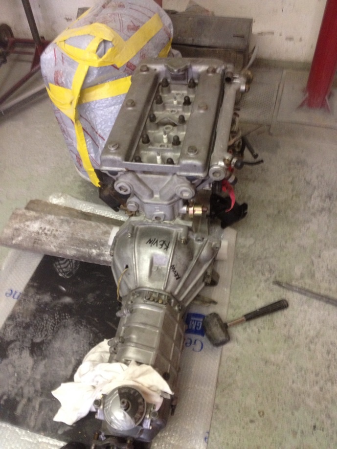

Engine and gearbox were loaded into back of car boot and rear seats and transported to Lakeavenue where we would put it together and install once car was painted .
At this steering rack and box is still with AK getting refurbed along with starter motor and alternator .
Some pics of engine in our outside shed

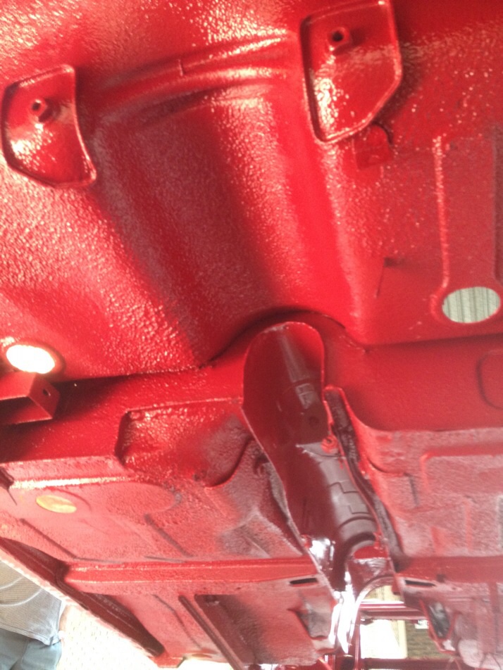

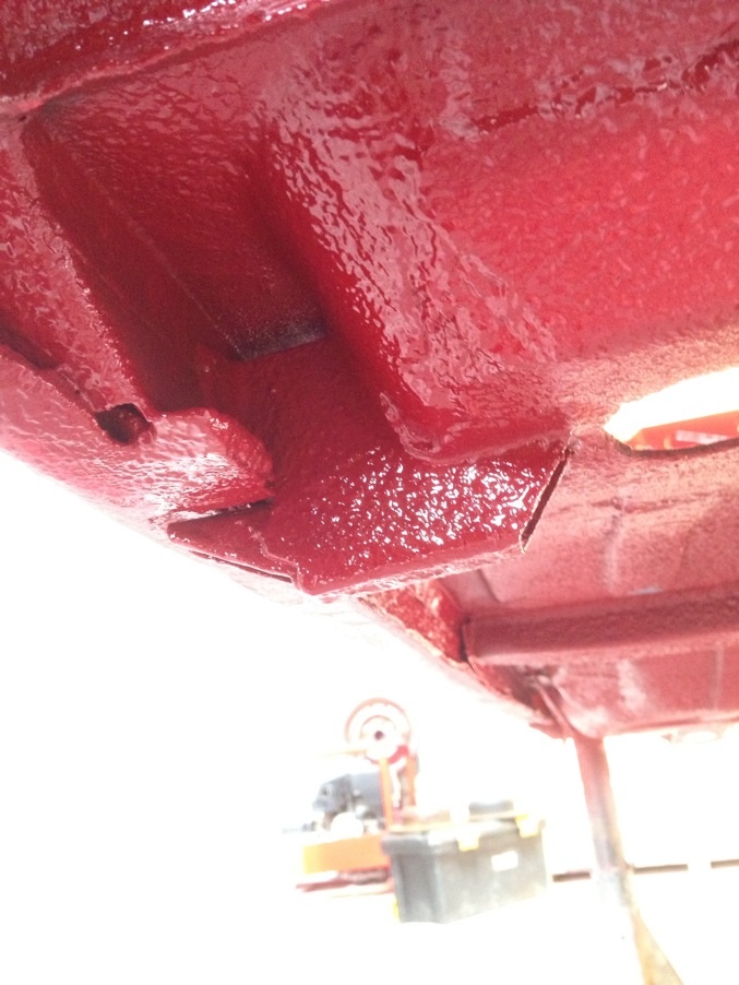

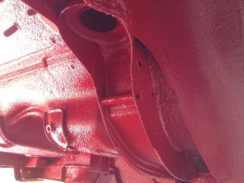

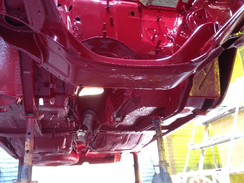

Some pics of the underside after all repair work completed . Can't quite see the true red as the are yellow screens alongside the car . Its always a pleasure assembling on a clean underside and keeps you motivated doing suspension assembly as its heavy going .

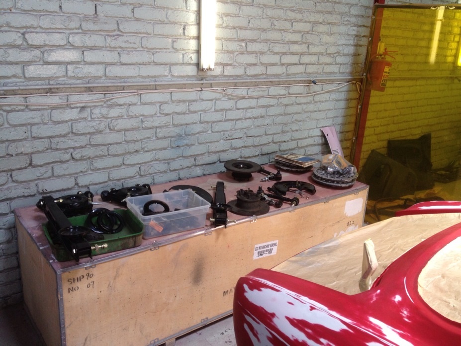

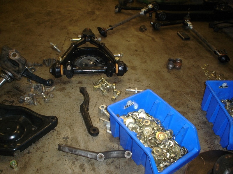

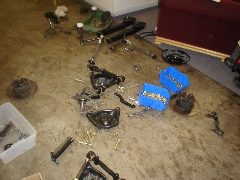

What better way to spend a Friday morning - sorting through AK classics powder coated parts and plated nuts and bolts and off course being continuously provide with beers from the "other " Kevin
This all took place just last month in good ol Jo burg in the sweltering 30 degree heat . Apparently beers were flowing fast today there with braai ( barbie) going according to my old man . If you're an Alfa nut or serious punter its a great place to be on a Saturday and I'm sure you will end up walking away with a classic .
Link to AK classics site .
Some pics emptying all the parts all over the showroom floor

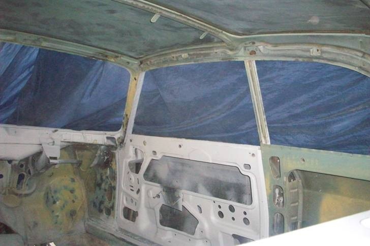

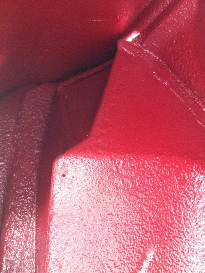

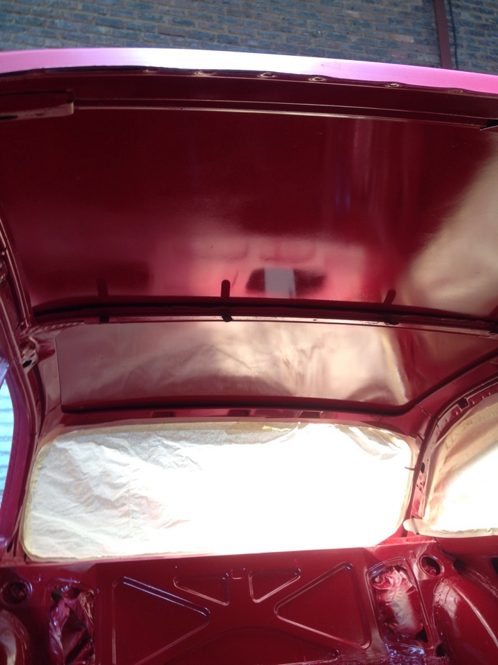

While suspension assembled the inside was painted after the usual prep .

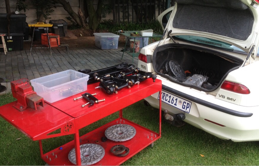

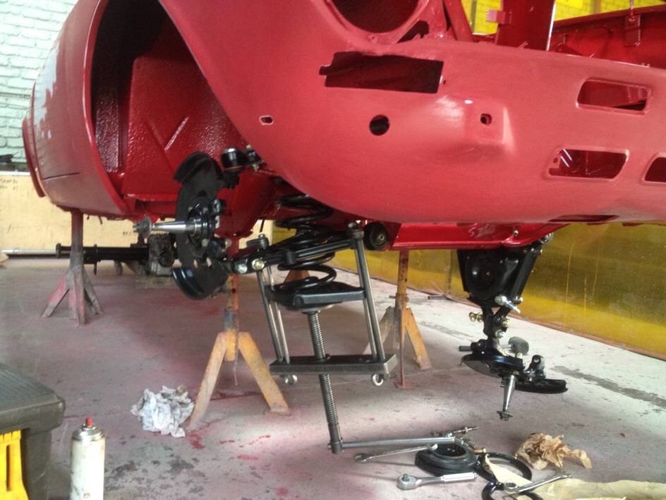

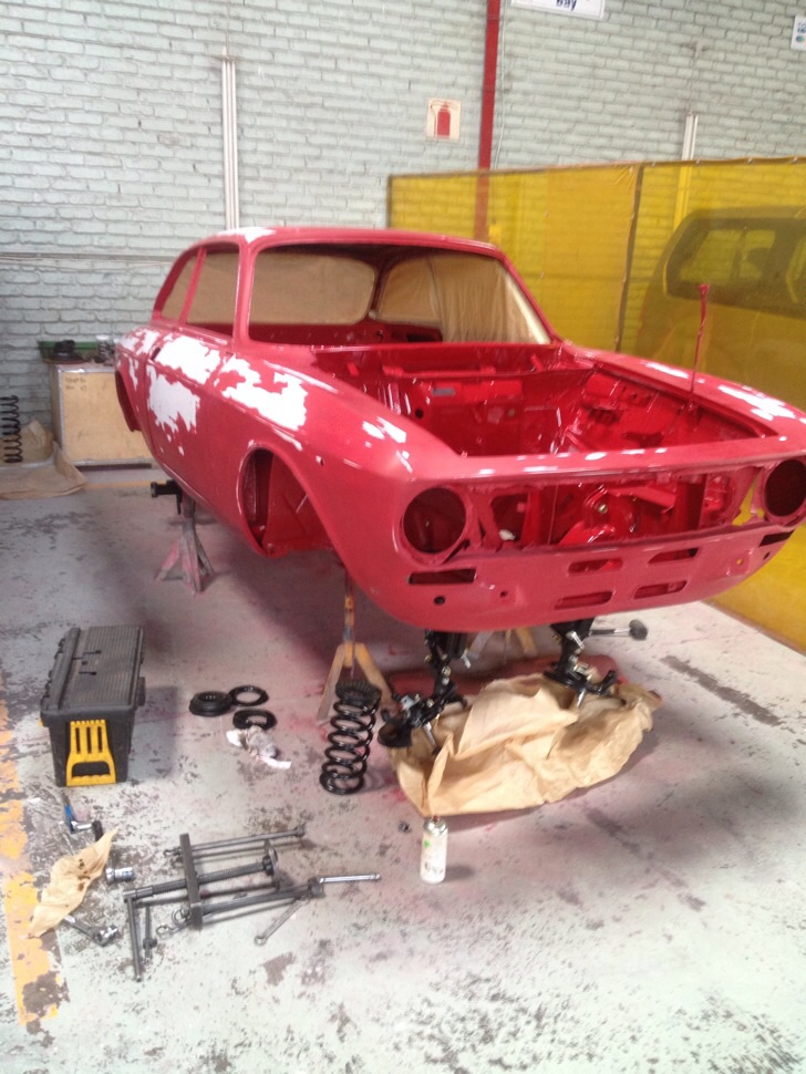

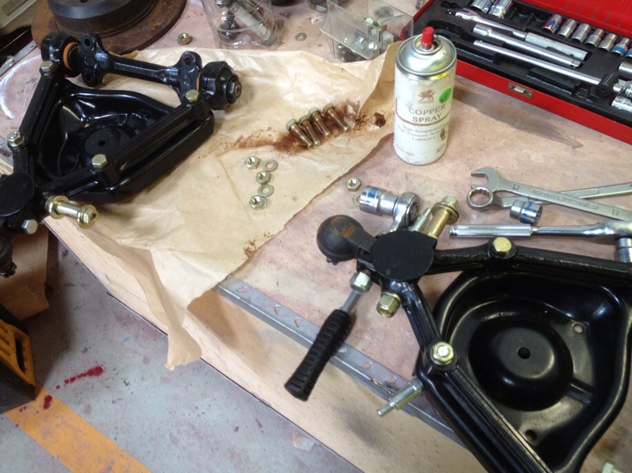

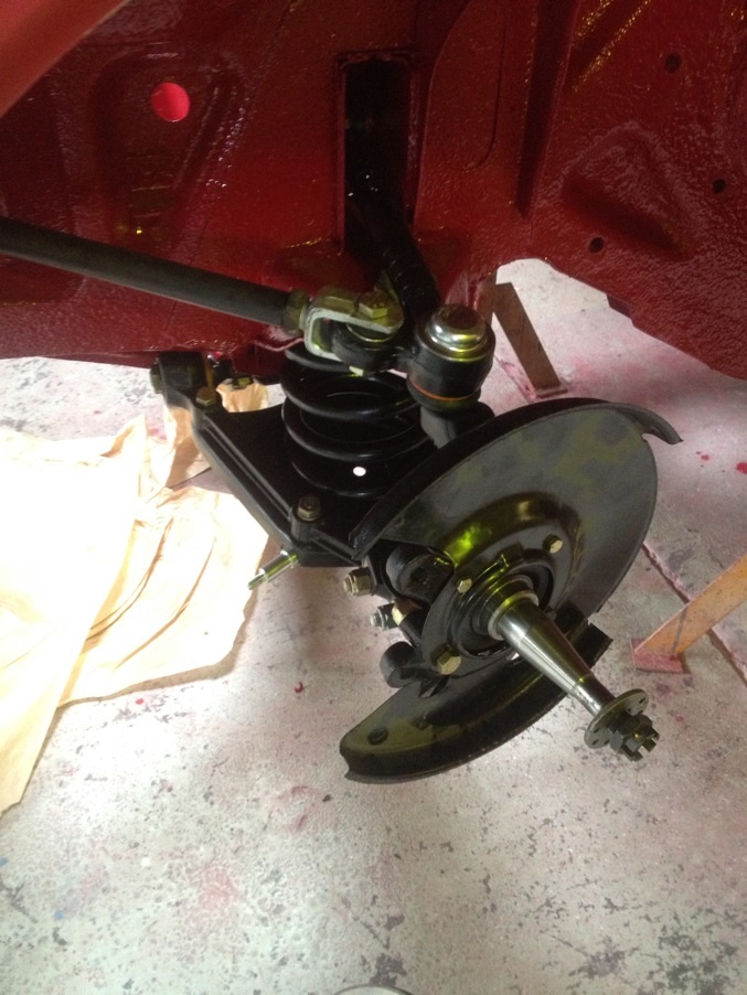

While external of car was been painted with a " check " coat to test colour and check lines I assembled the front suspension with the usual lubricants including copper grease which is a must . Carefull not to get it anywhere near wheel bearing grease . My dad took care of the wheel bearings .
The workhorse 156 used to load the diff straight off the table and slide into the boot . Always difficult when you have ruptured disc in back and your dads nearly 80 but that don't slow us down . I was impressed when he loaded the gearbox on his own

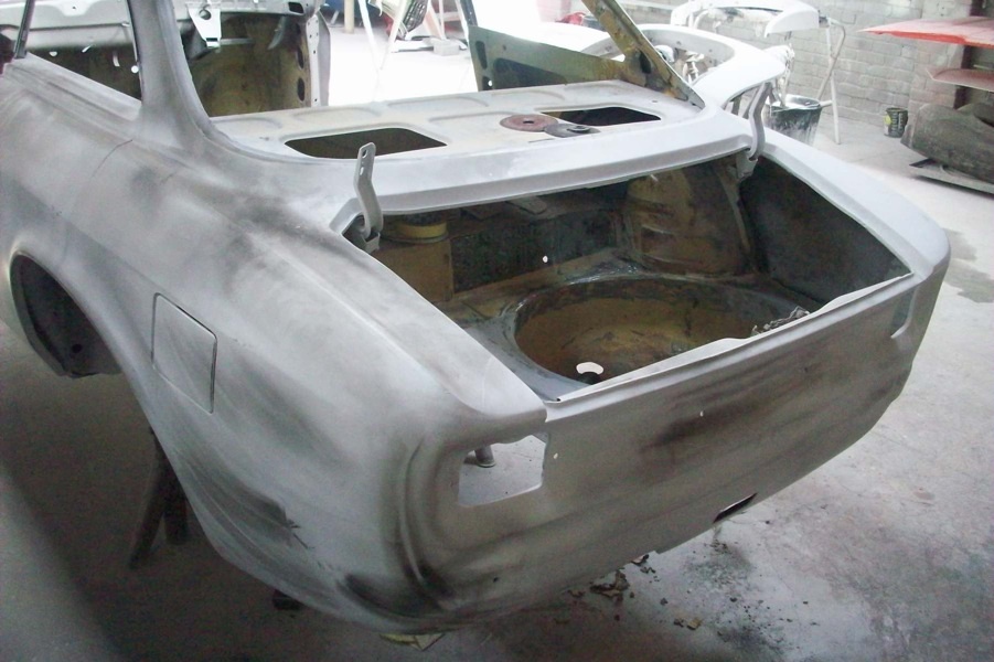

Thanks Joe , its been a lot of fun so far .

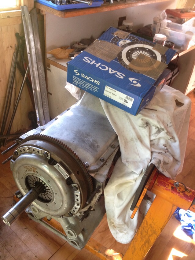

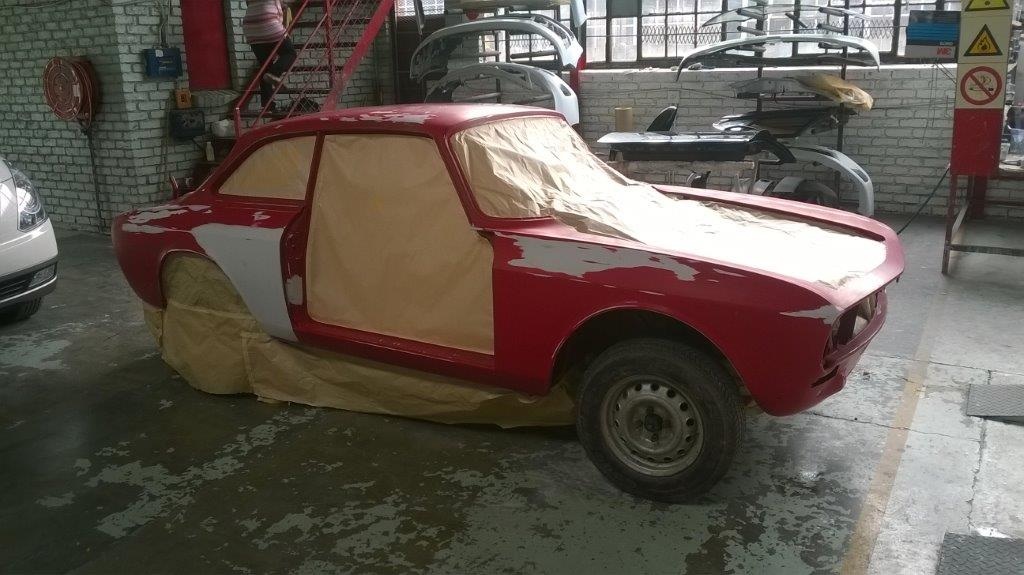

Some pics to add of the bodywork that's been rubbed down now that Fernando is happy with the lines . The engine has not been polished or cam cover been chromed but its very clean - an original looking . I'm afraid if its to clean the car wont be used but all the suspension parts will go back plated and powder coated to prevent any corrosion even though you not going to see it .

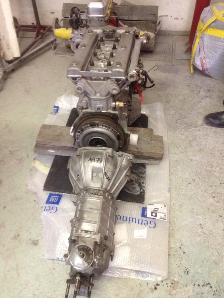

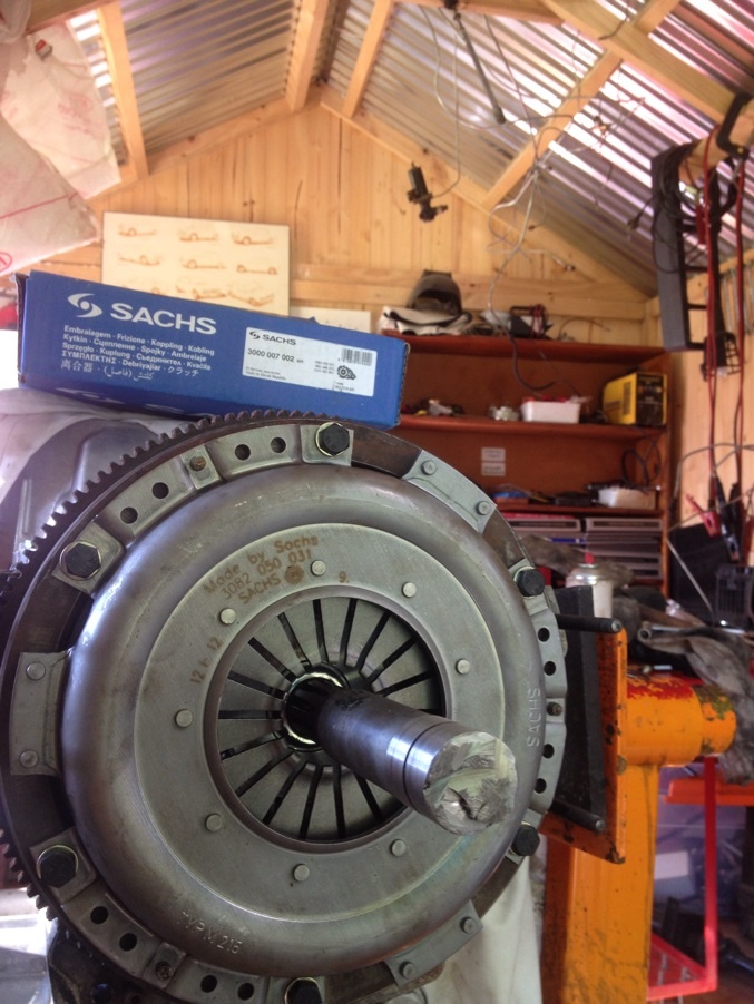

Pic of newly reconditioned gearbox mating up to the new Sachs clutch .

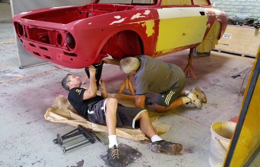

The original plan was to spray car complete and then assemble all the suspension but due to the ramp going into the spray booth we (Fernando ) have decided to assemble suspension and roll car in . It is light enough to carry it in but then you run risk of bending wheels arches . When car does get painted the underside will get sealed up to prevent any spray dust setting on the powder coated parts .
If AK classics never lent me the spring compressor I think I might still be under the car . Father son teamwork
and some good lower back excersise .

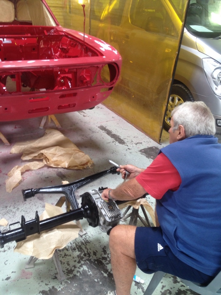

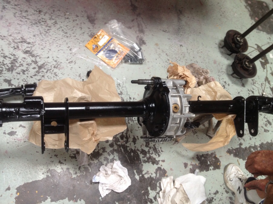

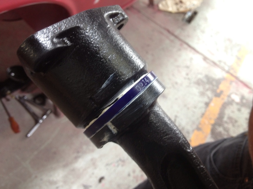

Re: Our 1600 Junior restoration

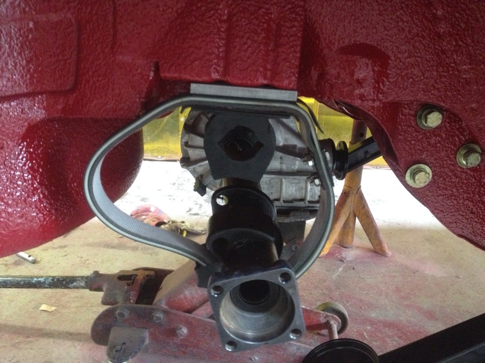

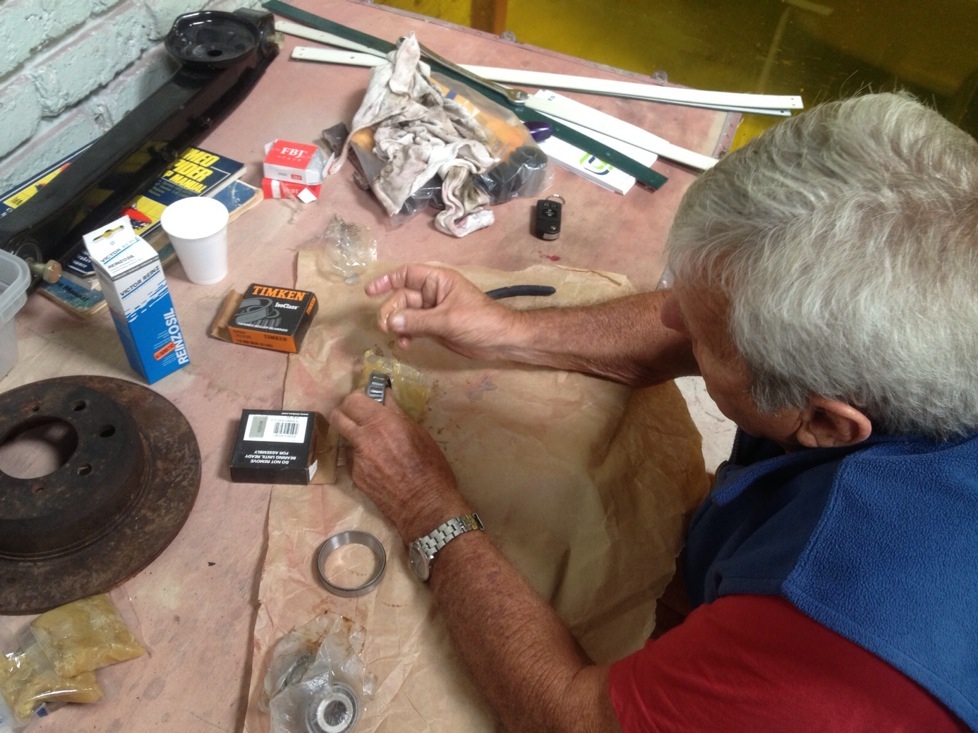

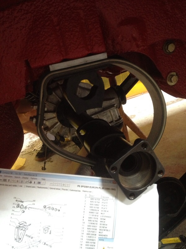

With the front suspension now complete we started on the rear diff . The old diff oil was drain and diff sump plate removed to remove any sludge etc which in fact was pretty clean . Definitely a two man job trying to put the diff in . I did pic up issues with the extra paint thickness and putting shim plates on the T bar but it was simple enough with enough copper grease applied . Also trying to be carefull not to scratch primer off and create a future rust spot .
Just trying to get cars on wheels at this stage so it can be rolled into booth so when finances are avaliable down the line I will replace discs front and rear . .
I could not remember which side the bracket that fits the straps that holds the rear axle sit but after downloading factory PDF from AK classics it was clear I had it wrong way . Pics here shows on incorrect side then corrected and again to get bolts correct way according factory PDF . Will update of that later .

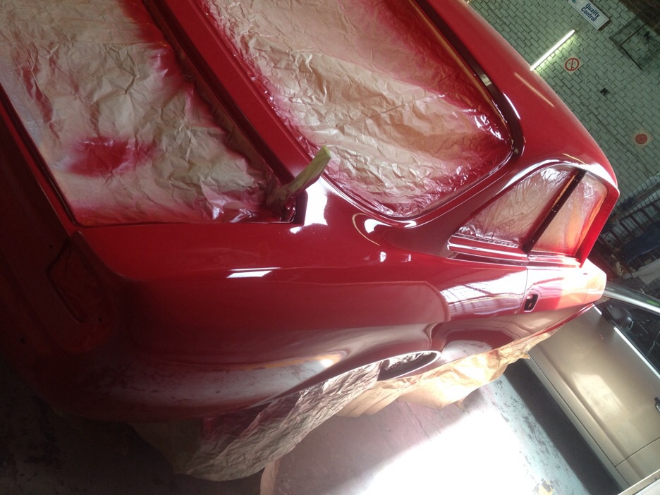

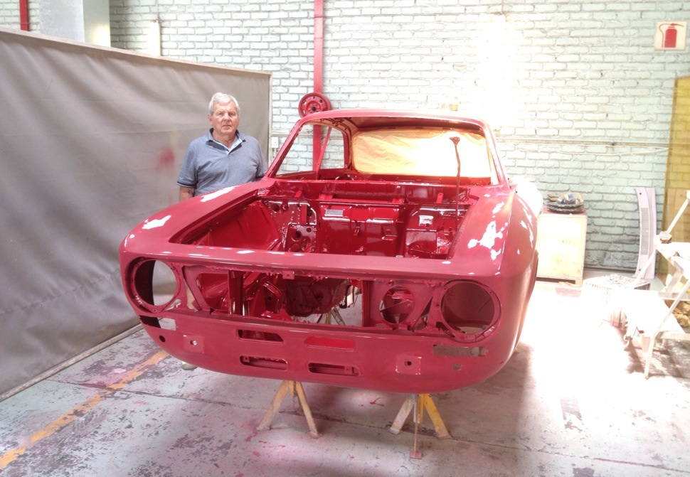

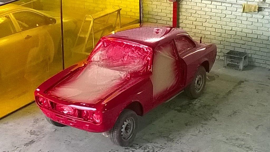

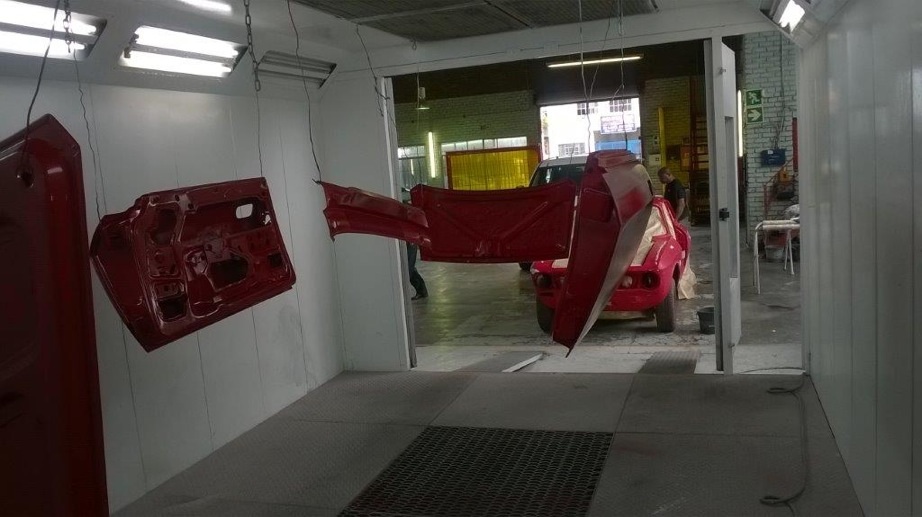

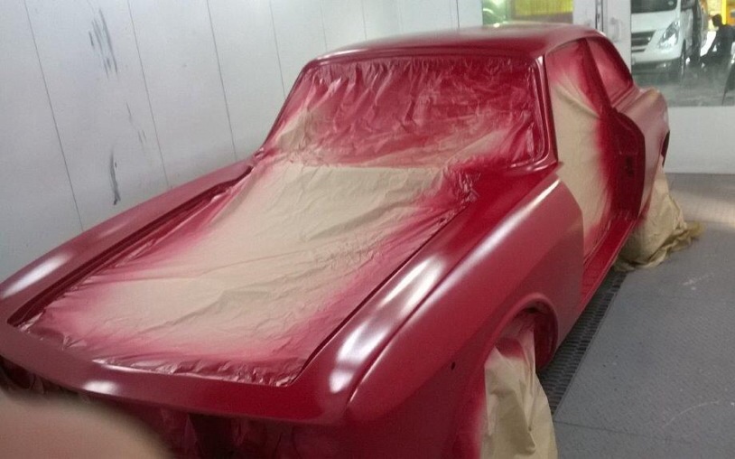

The last bunch of pics of car painted then my my dad will put motor and gearbox in . The steering rack is already to go in first . After that the hood lining and glass will go back .
