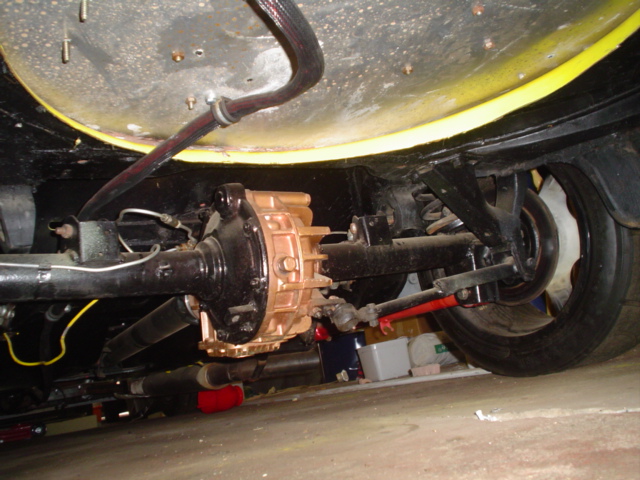

Greg,busy with a Fiat 131 Abarth fitted with a 500 odd hp Rotary...Fitted a Berlina 10:41 LS diff to it..
Shake down runs proved to be superb...
The original diff lasted all of third gear.
When I get to it again Ill shoot pics..
That's great Barry! What's a Berlina LS diff? Is that out of an Alfa Berlina? We are looking at installing a 131 transmission and a 132 rear end into the Fiat Spider. The 131 transmission swap will be bit of a pain, and I don't even know where I will find a 132 rear end.
Greg,Alfa Berlina,Spider,Giulia...all 105 cars,with ls version..
We have blokes here using these Alfa 105 diffs in 800 hp drag things...You know,the cars that cannot go round corners?? :wink:

Greg,The diff dimensions are great for the Fiat,like a shilling in a sheep's ass as they say...
Ben,The guys here are insane with these diffs...20l Mazda turbo`s with 3 stage gas..all through these little diffs...they are immensely strong..
Greg,Ill probably be doing the pics today.. :D

A Mazda 16v 20l turbo and 3 stage gas -800hp-all throughan ALFA Berlina LS diff....
