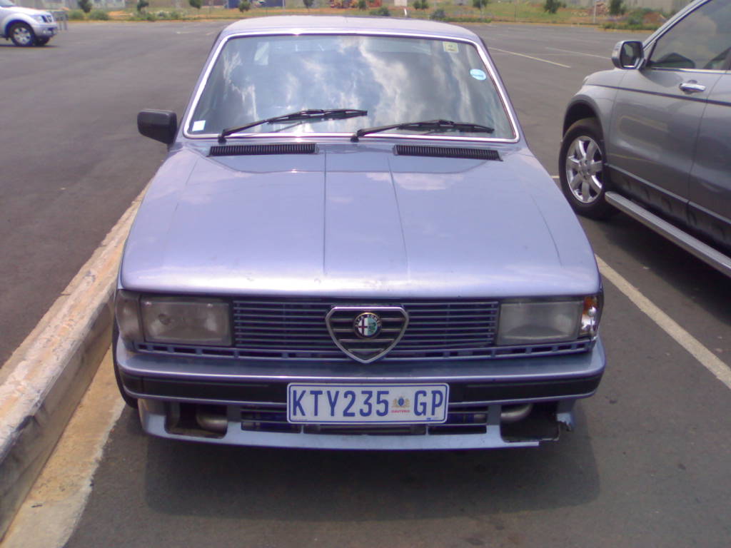

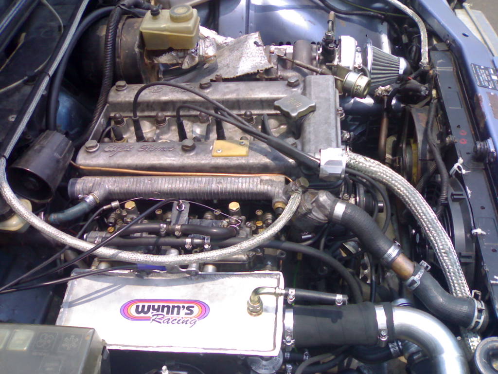

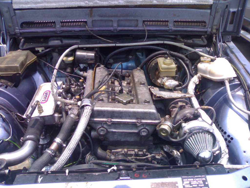

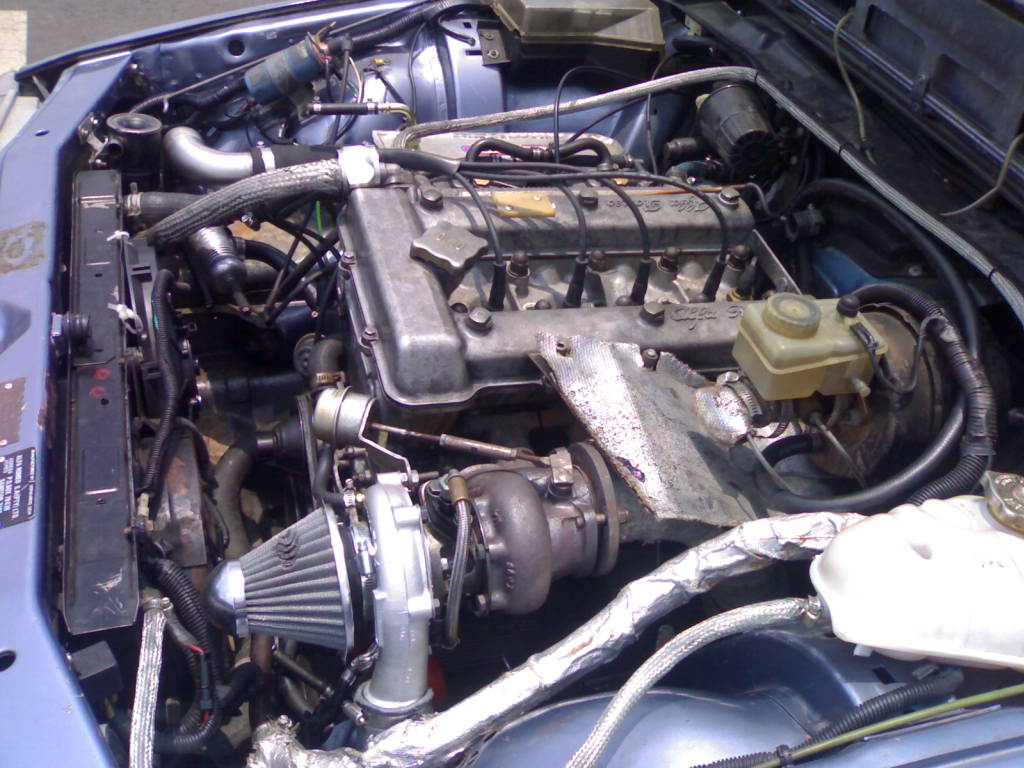

The Homemade Giulietta 116 TURBO
Post by nisaar »
Ok lets see 8)
:twisted: 2.0 standard alfa Romeo block and head
:twisted: Lazer Cut copper Head Gasket
:twisted: 7:1 Cr sliced fiat pistons
:twisted: Garret air research T3 / T4 Hybrid
:twisted: The turbo has a piece of cosworth and lancia intergral in it
:twisted: Big Ass Intercooler
:twisted: GTV6 2.5 brake calipers and disks
:twisted: Dropped suspension
Yip thats about it
The Car does wierd things with a turbo in it like
The engine bay gets extreamly hot and melts the bonnet heat shielding.
The Brake booster pipe gets sucked flat
The distibuter roter starts cutting at about 160 kph (the spring one)
If any one in south Africa has a left indicator lens I would gladly buy it

With that kind of underhood heat I'd think you'd want to get the air intake isolated from the heat and get cold air to it. I think Greg Gordon built a cold air box around the filter on one of his supercharged cars and it helped.
HTH,
scott

Your brake booster pipe must be replaced.I would suggest you get hold of some proper heat insulation material for the pipe as well.
I have had my shoes melt from the amount of heat generated by a Nord turbo motor on a hot run through to Sun City once.We got there and one of the security gaurds came up to me and said 'Sir,your bonnet is bubbling!' I still chirpped him 'Nice joke' only for him to insist I get out and look...the bonnet was indeed bubbling from the heat... :shock:
Other than that,enjoy her my friend.

Thanks for the heads up MR2 Zig but my only problem with this car is space... I can't have the air intake to low either with the currant rain situation here in Jo burg. Its been raining Buckets .

what I remember is that Greg ran a piece of sheet aluminum back from the radiator support to just behind the airfilter thenbent 90deg and went to the inner fender. He then closed the bottom. The top was the bonnet itself and there was a seal (door sealing strip i think) along the top of the sheet metal. air was let in thru a existing hole in the radiator support.
Once Greg gets his supercharger in the GTV6, it looks really tight also.
hth,
scott

MR2 Zig I think thats very possible cos I drilled the inner fender already for ventilation I'll take your advice and Macgyver something there ....

Thanks Rookie and Greg I really appreciate your Guys input. As you see my intercooler is quite big so it really cools the air down, but I am gonna shield the air intake from the heat.
