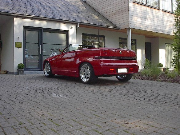

Post by rz »
i own an rz and i think there are no substantial differences in chassis , only in the suspensionpart.the car sticks to the road ,but a lot of road noises and squicks are passed through to the driver!
ed van de beek knows all about the subject,i'll give his site adress http://home.wxs.nl/~evdbeek/monster.html
this man should know it all

Thank you!
I'll write him an email!
BTW -Your car is amazing! :P
