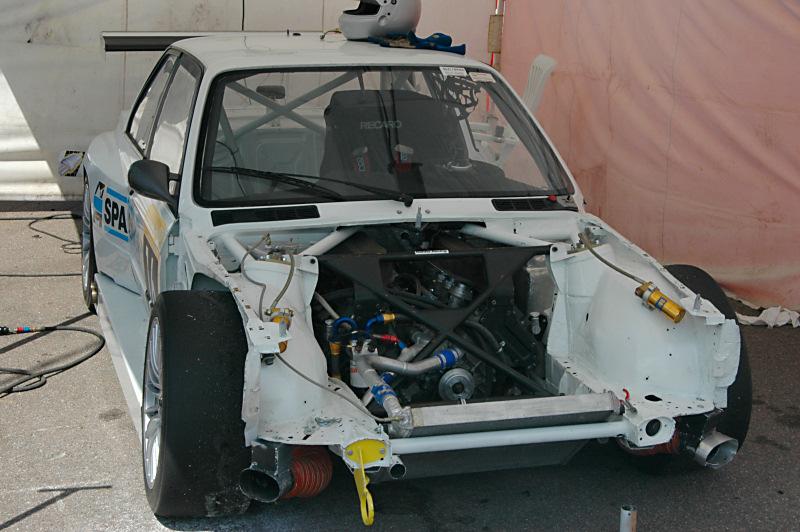

oops forgot my favorite pic bloody e30 m3 :shock:
Re: Moving The Engine Back
Actually that is a real DTM body... Bastardized.... :x
4 liter V8 and quite a lot of grunt though.
