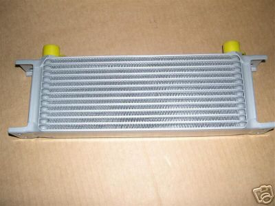

What do you look for in a good oil cooler for 4 cylinder alfa.
What size, 13 row minumum?or go for a surface area size?, i've seen long 9 row ones cheap, i think off early mazda RX-7's.
What about transmisson coolers used as an oil cooler? are they up for the high engine oil pressure? Hell could you even use a small aircon condenser? :lol:
questions questions questions........
Thanks Matt

Yeah Matt- looks like you've got the Serck 16 row oil cooler like I have on my car.
Cools it plenty- never have issues with it- I only have the factory presure gauge to go by, but in contrast, my mechanic had a series 5 Turbo RX7 cooler on his Alfetta with my engine, and said that it cooled the oil too much on the freeway...

I installed a Mocal unit on my milano/75 and used a Mocal sandwich plate with build-in thermostat as barry mentioned. Though, this was on a 3 liter V6, but the cooler fits nicely in front of the radiator - this was mainly to better control temperatures on the tracks around here in the SoCal desert.
Cooler
Sandwich plate with thermostat (lower half of page)
