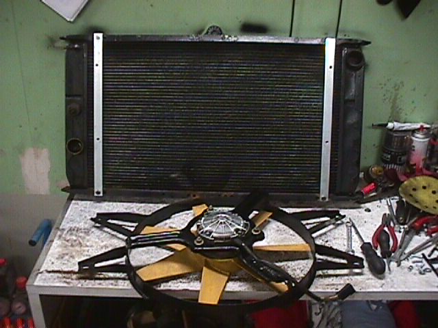

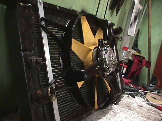

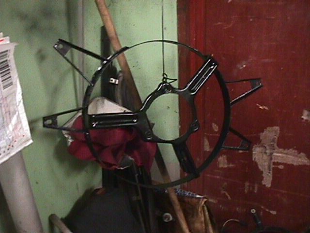

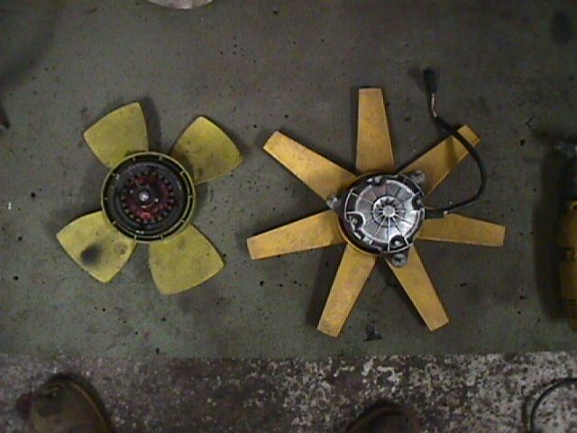

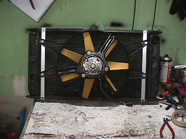

Hey Guys!
Got started with the fan rebuild last night. Not much to report but few pics. Got the radiator out and started fitting the fan onto it.
Also gave the frame some new paint...
Did not quite finnish, but got a bit on the way. Will keep you posted.

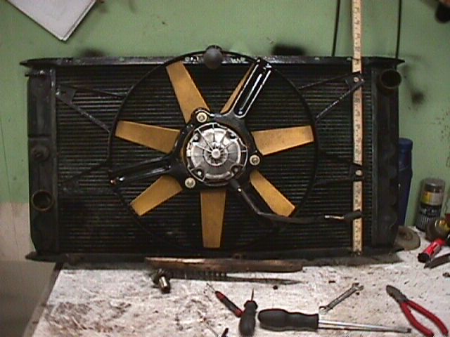

Tonight I got the fan-conversion finished. Went without any probs. Thanks for the tip Dennis!! :D
I hope this will be sufficent for the swedish summers. But You said it works fine for You right, Dennis?
The result:

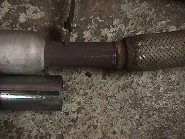

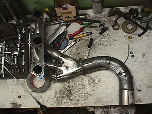

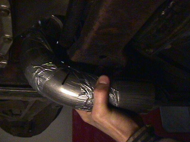

Long time no posting. :wink: Anyway, some things has happened since last. I´ve bought headers from Glenwood (through JJ) both to this car and to the 75 track car.
I´m at the moment in progres of building the "down pipes". I´m making them of 2,5" 90 degree bends. Pretty big, but with a snug fit it´ll work fine. The old original pipes and mufflers/detonation dampers(?) are replaced by 2,5" pipes back to the flexpipes.
I don´t have all of the pics here with me, but I´ll post the rest later on.

Some more, will post more later on, and after the weekend, when hopefully I´m done! :)

Hey Seb,
Those headers, they are not equal lenght are they?
Seb
Posts: 222
Location: Gotland, Sweden
Post by Seb »
No, not "extractor" pipes, but FAT headers! :D Inner Diameter of 40mm.
