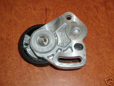

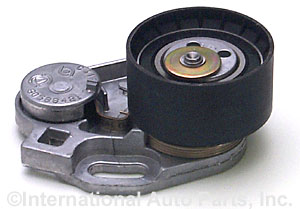

Here is my latest thought:
old 'new' style thermo tensioner for Milano, gtv6, and new (mid 1990s)thermo tensioner for the 156,166, etc..
Dimensions are similar. Slightly increased arc in newest style. There is a belt guide on the pulley, too. I know the newest style tensioner is for the x4 cam 24v, but looks like the belt path is over top of the pulley like on the older 2.5, 3.0's. Or, maybe it runs below the pulley??? I know Alfa made a few changes to the new block but maybe, the newest (mid 90's) tensioner is an improvement????
The quality of this 'made in Canada?' piece appears pretty good....
