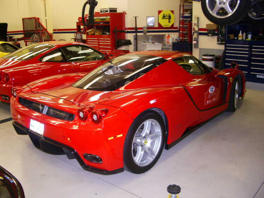

and here is what i get to play with sometimes
work
work

I might be wrong, but I don't think you can legally place a Ford Escort next to a Ferrari........even in pictures
