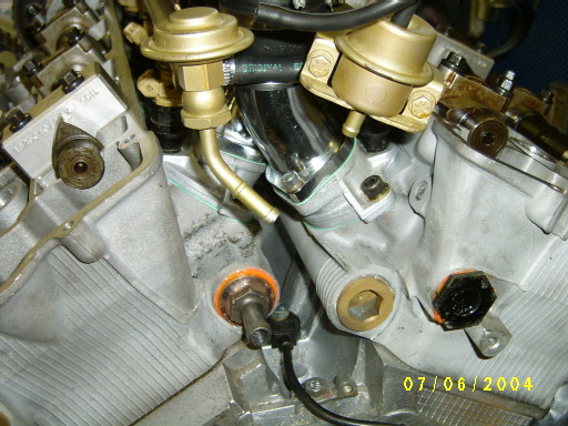

LENZ
Posts: 72
Location: Holland
Post by LENZ »
This is the way i did it on my 24V conversion
24V cooliing connections.JPG (96.33 KiB) Viewed 7331 times
155 3.0 V6 24v Q2 NovaCorse
