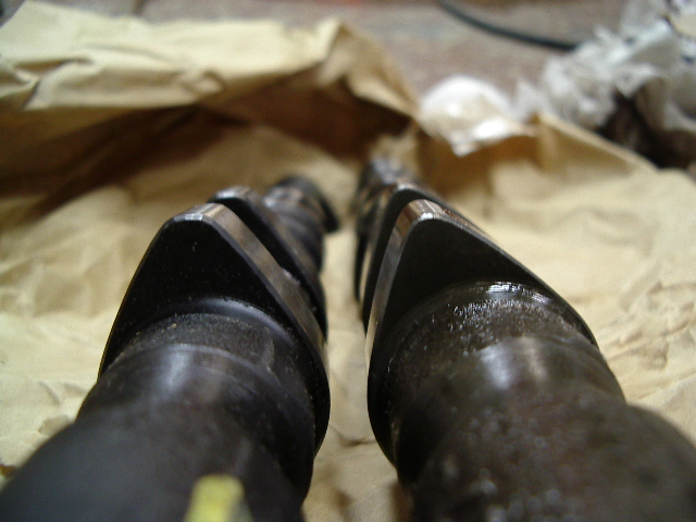

Have been searching both this forum and googled around, but have found no data on the inlet valve timing of the 3.2 V6. Exhaust valve timing are obviously the same as for the 3.0.
Lift would also be nice to know.
Anyone?

OK, found it on a elearn disc...
3.0V6 are 236 duration, 3.2's are 243...
Really, isnt the difference bigger? Looks relly different when compared:
