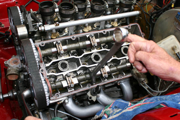

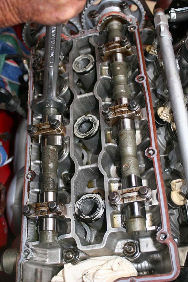

Michael, as the shops are all close over weekend I could not borrow any tools so you can do all of the service with no Alfa tools. All that you must make sure of is you rotate the motor twice and check your belt tension after you set up timing. All the marks are on the cams. The first time i did a belt chainge on my 24v motor with new standard tensioner I was so paranoid I got all the tools including the weighted arm and did the job. Now that i know what the tension should feel like inthe belt I dont even borrow the weighted arm anymore. The one dealer down the road from does not even have a weighted arm. Regarding new pulley bearings, they corrode(the outside) very quickly so a new one can look pretty old but the blue seal insde should still look new. Two pics to follow showing cam timing set up by loosening the pulley then rotating cam until its on the marks cut onto the back of it. you can just make out this mark in the second pic as it lines up with the head. There is more detail to this of which lobes face where while the engine is on tdc but that can be explained.
If you get cam blocks buy a set of longer cam bolts or any other seven mm bolts(just for timing set up) as the thread on a standard cam bolt through a cam block is just to short and can sometimes strip.Difficult to explain this until you see the force the cam exerts on the cam blocks as you tighten it down..
Following pics of todays work
See tiny cut mark on back of exhaust cam.
