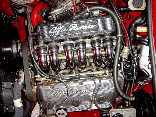

This is about as much shine as you can expect if you have a go..I'd go the yellow.
3 Litre Plenum Convesrion.jpg (186.74 KiB) Viewed 10599 times
