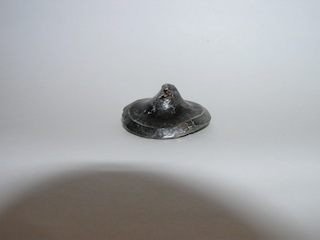

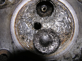

- Probably repairable, but not worth it.
- P1010017a.jpg (53.5 KiB) Viewed 10798 times
- Not much useful info here.
- P1010016a.jpg (14.12 KiB) Viewed 10798 times

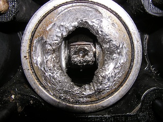

- Is the rod even salvageable?
- P1010003a.jpg (48.55 KiB) Viewed 10798 times

Rod in my opinion isn't salvageable, head probably is, but the easiest solution is to drop that 3L in.

Older sodium filled valves sometimes break at the fuse point. If this was caused by overheating or not is hard to tell from just these pictures. Because the valve ended rattling around, it's hard to say even if you have close ups of the break surfaces. The breaking is a combination of weak design, fatigue and lesser quality of manufacture and of alloys used. One or more of these could very well have been a contributing factor.
