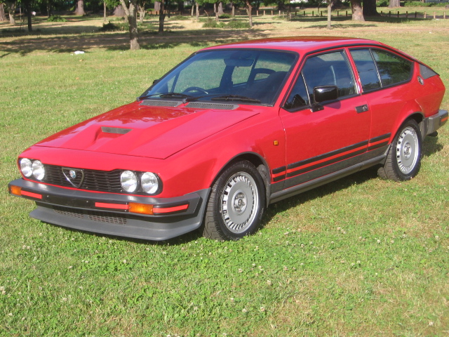

Thanks Kevin ; I will be sure to give you a call. My objective is to keep the car as stock as possible ; with some savy upgrades mostly centred around the chassis , braking and handling. Each of which can be done at my leasure and returned to stock easily being " BOLT ON " only .
I do not have access to the equipment to pull the engine and running gear or I would certainly do so myself including the Engine rebuild ; so I am farming it out to a local guy who has given me excellent service in the past. I am trying to get an Idea of what others may have spent in terms of a budget as I need to put a cap on this or I will go overboard !!! :lol: I have owned this car for 6 years and bought her as an unfinished project.
My car is a split dash '84 ; needs some tlc in the bodywork department but nothing huge or major. The Engine and running gear will get all new parts as required through September , I plan to order some koni's through Steve and will look into possibly getting a handle on an RSR kit depending on import costs later. I want the motor stock ; although my car has been played with by some before me and has headers and a good 68 mil exhaust throughout. The carbs I rebuilt myself as mentioned before , the Chokes are 36,s and I am running 140 mains , she will pull to a 6800 RPM rev limit here at 240 indicated at the drop of a hat !!! I think she has a set of Dawie's Group 1 cams as I cannot get the idle below 1200RPM , somewhere I remember reading that the Group 1's cause a high idle ; may be wrong though !
Enjoy the pics ; unfortunately nothing sideways down Franshoek this time though !!! :lol:

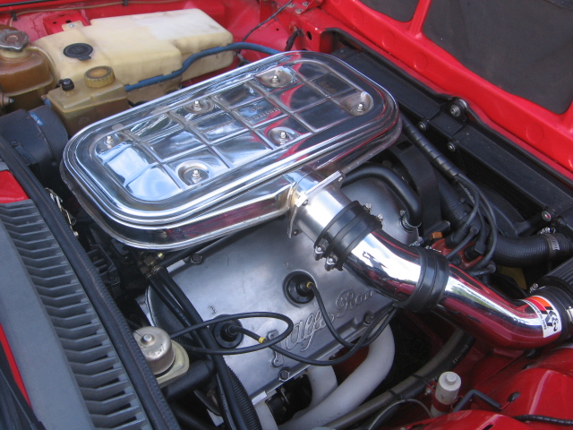

Nice car.
Not that it pertains to the questions asked, but some heat sheilding around the air filter would be a good idea to limit the potential to draw in hot-underbonnet air. Also, I'd assumed that the scoop in the hood was functional, given the location of the plenum on top of the carbs - not so? (or is the piping off to the side not OEM?)

The scoop on the hood of the road car was not functional and was made in that fashion only to clear the Airfilter housing on top of the carbs. The Stock intake for some of the 3.0 litre cars I have seen also featured a modified housing with a double intake to feed the carbs , this apparently gave an extra 10 hp over the stock housing cars like mine. I do believe Kevin has posted pics of his Grey 3.0 litre showing the '85 style modified housing.
My car is basically as I got it ; save some small concessions to modern reliability. The original intake runner and choke assembly were removed and the previous owner had fitted a large diameter ribbed rubber tube for intake. When I opened the Airbox housing up for the first time it was clear that the securing ring for the airfilter was rusting away so I had to remove it and make a plan for filtration , therefore the K&N at the end of the runner. There is a ducted , cold air diverter behind the grill of the car in this area which feeds cold air to the intake when at speed. The car sounds just fantastic breathing through that alloy runner and K&N , always a pleasure to drive with the windows open !!!!!! :D
The Dellorto's on the stock car are very well set up from the factory and they dont go rich at the top end which shows a limit to airflow ; I have done a few trackdays at the local and must say the only thing I found wanting was the brakes. Looking at getting that seen to with some suspension work too , just simple upgrades mind !!!!!!! :P

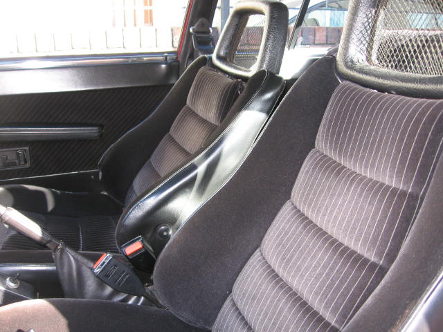

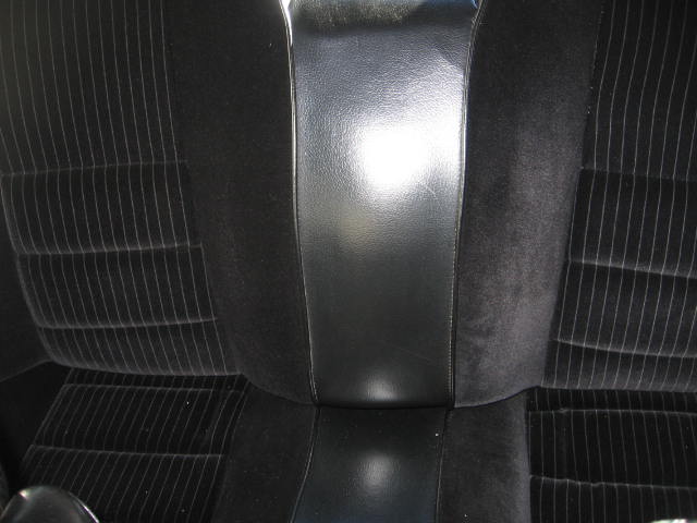

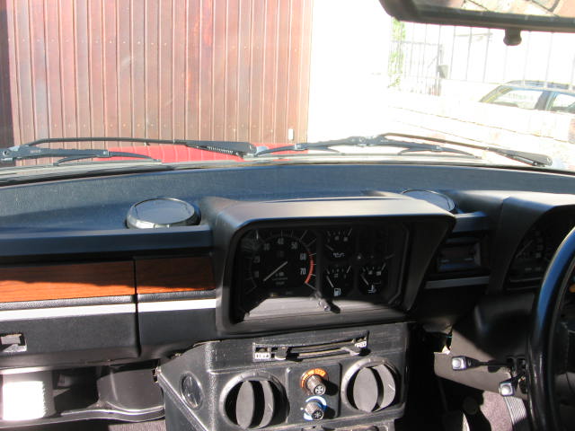

Hi Kevin ; pics below show front and rear seats , and dash. I will get to the interior after rebuilding the car also , my problem is the two front seats have splits in the vinyl sides.
I recall you posting at some time that you may have a contact for the original pistripe material ? May need to send you a case of wine or 3 for a bit of that material.
The interior has very little fade ; the rear seats are almost perfect with a little wear and tear on the vinyl , the material is good. The roofliner is perfect ; the dash is almost perfect with no cracks , just a little bit of lifting the size of your pinkie nail in two corners.
The carpet needs replacing , but its not actually too bad.
