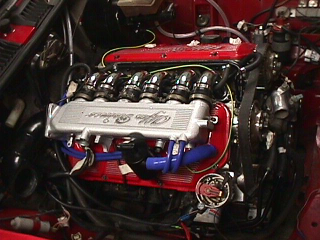

Seb is doing a great job here guys but for the rest of us who have the pedals in the correct spot (namely on the rhs)
This arrangement will not work due to fouling of the clutch master cylinder which is not in the photo.
The solution for RHD inlet manifolds is to block the end off at the firewall end and open a new spot on the side of the manifold where it will still allow you access to the spark plug for maintenance. Works just as good.

Thanks MD!
The way you mention to block off the end and make a new hole in the plenum is actually better even in my case. But I´m a lazy bastard and this will have to do for now. The plan is to make a custom plenum and runners in the future.

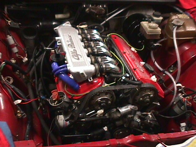

The brake cylinder is showing in this picture, to the right.
It´s btw funny it´s called Right HD, when it´s obviously so wrong! :P

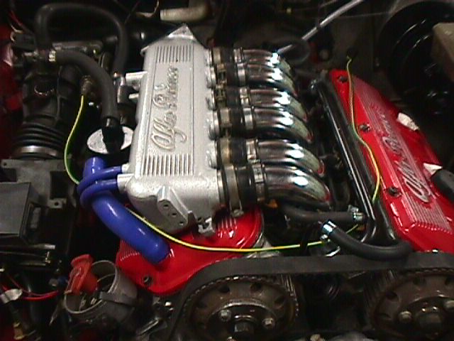

Well, this is where you flip-flop your intake runners and have the intake manifold "hover" over the other valve cover... That way your intake plenum is now alreay facing forward without the need to weld and manufacture the 180 dgree bend that some like Beninca seem to dislike...
The "only" welding involved then is moving your oil cap forward on the other valve cover.... (A must any way.)
Wouldn't that interfere with the brake and clutch MC's?
Looks tight enough as it is..

It doesn't on the right-hand drive GTV6 that I saw (Dawie's test mule...)
Dunno - mybe it was already converted.
I have seen guys use the 164 booster as they are bigger but flatter...) with an Alfetta pedal box...
This car is LHD, and if you look at the pics the booster is like 1cm from the left head.

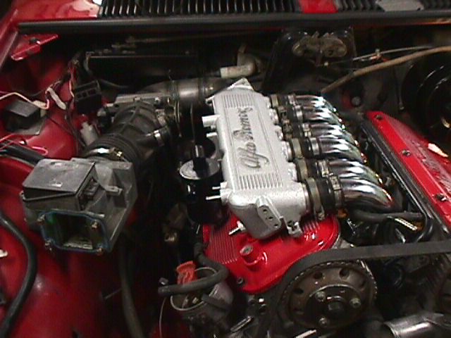

With the intake moved to the RHS, it means you cannot use the original air cleaner set up (if that is going to be an issue)

I´ve started to put new hoses for air, water and fuel on it. Also I´m modifying the throttle and the wire. Since the throttle is in a new position, I have to make my own solution. I will give you more pics on that later. Here are some pics showing the Samco tubing...

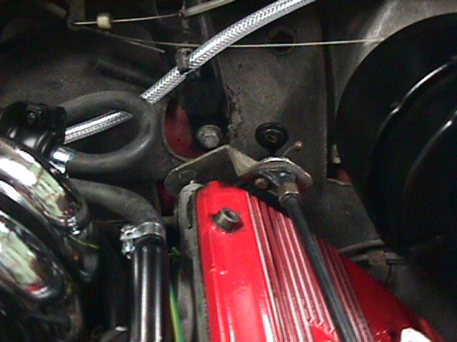

Now I´ve modifyed the throttle housing and figured out how to place the throttle wire. The yellow cable shows how I´m gonna place it. I´m using the "hand throttle" to pull the wire now instead. The original arm I had to remove to fit the 180 bend.

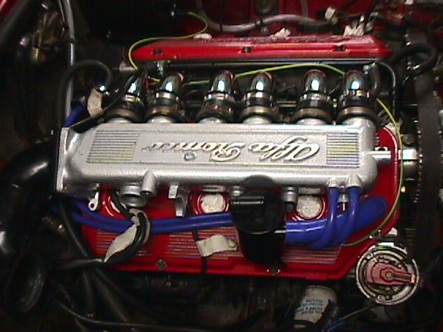

Long time no see! I´m finally back working on the 3.0-conversion again. Most of the winter/spring/summer has been put into the race car. But now its time to get the GTV6 started.
I think I have all the wires under controll and the throttle wire is modified.
In this photo You can see how I used the "hand throttle" to the right for the throttle wire.
