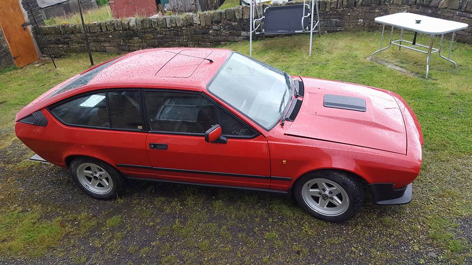

conversion complete
just waiting for my bumpers to be painted then its finito

Re: Need s some advise on converting my Alfetta gtv 4 to a V
It may be that you already have a plan for this, but you will want to get the computer box into the passenger compartment somewhere. I have no idea where it goes on a right hand drive car. On the US market cars it goes on the right side panel just in front of the door.
That looks really nice!!!
I hope this helps,
Scott

darryl longley
- Posts: 102
- Joined: Fri Oct 07, 2005 2:03 pm
well spotted
I am re-loacating the ecu to inside the car and as you quite rightly said it goes neatly inside in front of the the door and under the fuse box
