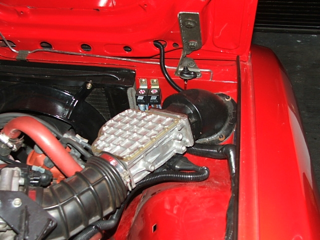

I guess this is a relative thing depending on where you live but irrespective of where you do live, sooner or later, it's going to get tropical under that bonnet if you get on the loud pedal long enough. The hotter it gets under the engine bay, the thinner the air and the less the charge of oxygen into your combustion chamber if your air intake lives under the bonnet and attached to one of those "nice" cone filters or whatever. Here endeth lesson for newbies.
What follows is a photo collage of a very discrete installation of a 164 air filter box into the front RHS guard cavity of my GTV6.

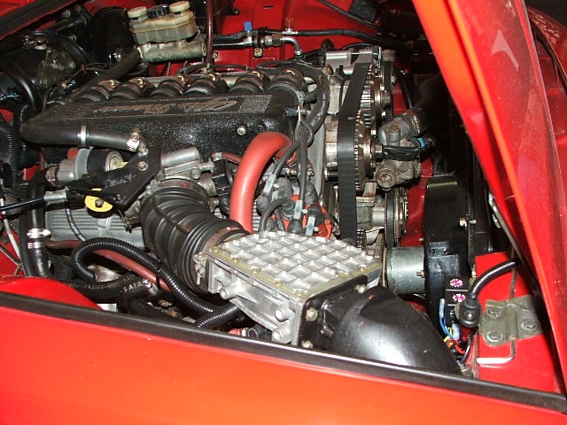

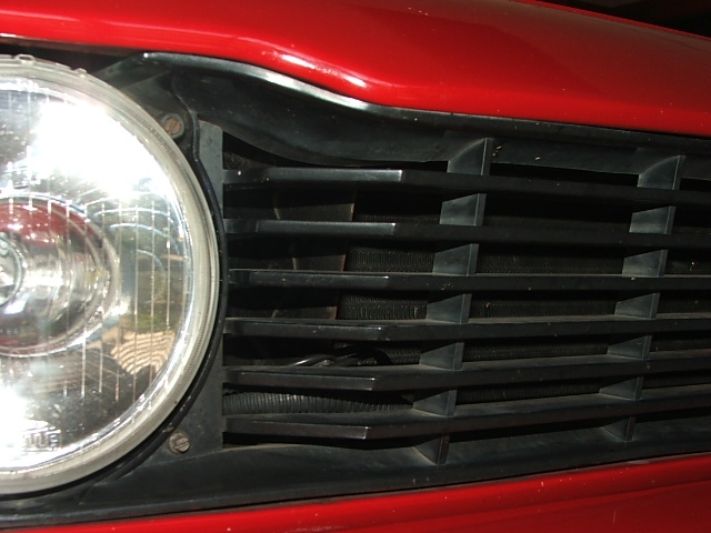

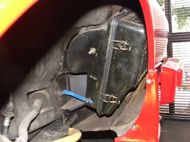

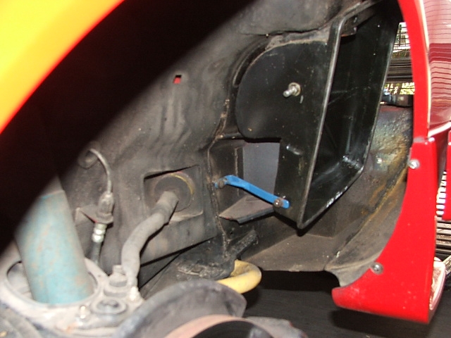

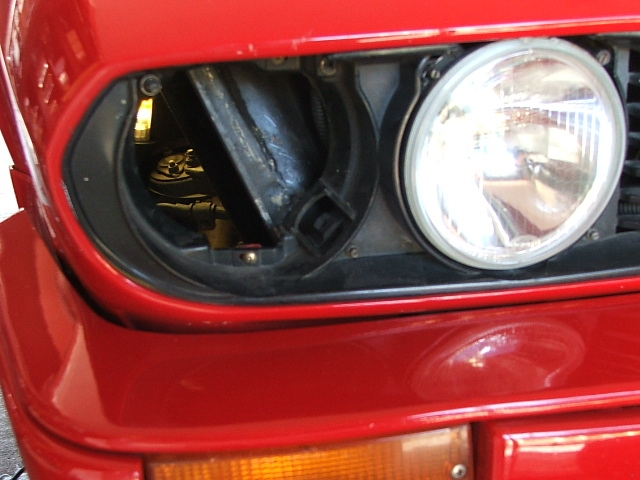

The intial air intake is next to the inner head light. A scoop behind the grille conducts the air into a closed and sealed cavity of the guard. From here the air travels into a modified filter box, through the filter and enters the engine bay via 90 degree mandril bend pipe. The outflow from the pipe goes via the AFM and into the inlet manifold to make ZOOM. !!
Leaves lots of room in engine bay and has a slight ramming effect at speed. Food for thought for your next project. ( the sequence may be a little out of whack but I am sure you'll get the idea)

- Cold air Scoop next to light.jpg (163.18 KiB) Viewed 16380 times
- High Low headlight removed.jpg (163.39 KiB) Viewed 16380 times
- Cold Air supply to engine.jpg (212.28 KiB) Viewed 16380 times
- Cold air inlet from filter.jpg (184.6 KiB) Viewed 16380 times
- Standard 164 filter cartridge fitted.jpg (161.4 KiB) Viewed 16380 times
Cold air intake
Part two:
(something tells me I should have swapped part one for part two, but you get the idea I hope)
- Air filter base installation.jpg (163.63 KiB) Viewed 16373 times
- Filter and cover installed to base.jpg (173.26 KiB) Viewed 16373 times
- Splashguard and pressure seal refitted.jpg (174.87 KiB) Viewed 16373 times
- It all starts here.jpg (169.45 KiB) Viewed 16373 times

Ah, no flies on you Barry. Yes the filter is a bit of pain to change but you can slot it into other jobs like tyre rotation time so it is not that bad.
As Micke says, apart from having a snorkel at roof hight, for practical puproses, it's about as cool an air supply as it is going to get.

Oh yeah. I forgot to mention that I had the modified air cleaner package tested on the flow bench with the original 164 filter media and it flows up to 520 hp. Like wow man, if only i had the donk to match it.

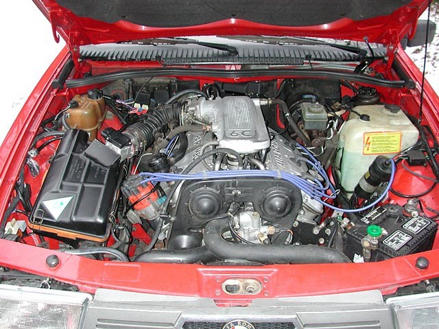

Nice setup MD. I'm currently deciding what to do with mine. The car is fitted with a horrible clamp on conical filter
I bought a very light ITG box several years. Hoped finally have a car it will fit in. While diameter is just right. Unfortuntely there doesn't seem to be enough space. Moreover OEM box seems to suck the air straight from the front. While this setup gets hot air from engine bay. Any ideas what you've seen / tried welcome.
Re: Cold Air Intake
Have a close look at the 75 air cleaner. It may fit and all it would need is a more closer coupling of the inlet to the area in front of the radiator.
