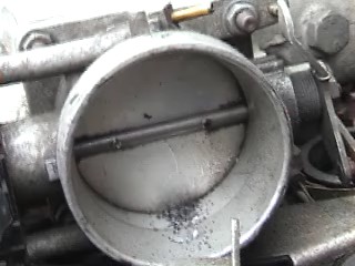

What was found in the intake

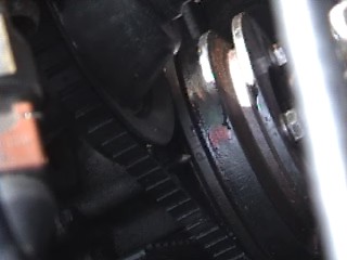

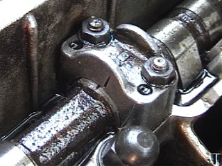

The out of time cam on the drivers side
Alex

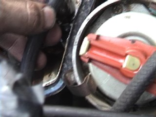

Distro

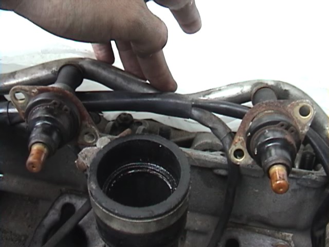

Heres a pic of the #4 injector and the #5(#4 is on the right :wink: )
I was running at about 4000rpm in 4th maybe 25% throttle on what I think was pretty level road. I had been driving for about an hour and half some of which was somewhat hard driving and it was pretty hot outside ( though the car was running where it should around 175 degrees)

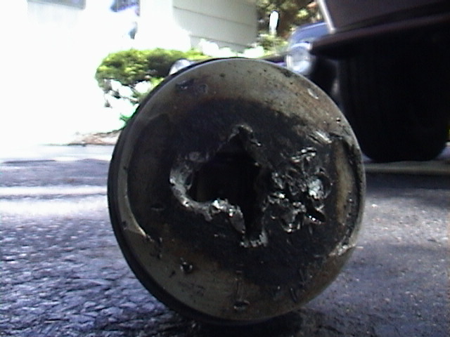

This was probably caused by either a bad injector or a bad injector seal on #4. This is quite common on 20 year old cars running original injectors and seals.

I don't think the small cam mistiming is what killed the motor, nor does the driving you were doing sound like the problem.
If you still want to investidate what went wrong, then try and hook up the fuel rail and look at the injector flow patterns. If #4 is much weaker than the rest, then that is the answer, not enogh fuel for #4 cylinder, lean running leading to detonation and piston failure.

I got the heads off and the piston out. Heres what I found :shock:

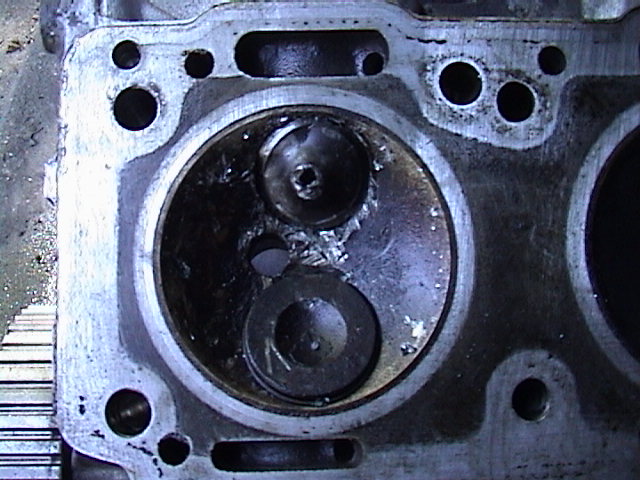

Post by Octopussy »
:cry:
