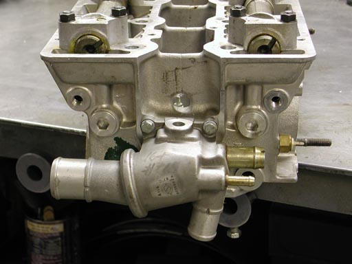

The "elbow" you're looking for is the original 155 thermostat . . . see photo. It points toward the exhaust side, but may allow you to eliminate the u-tube that's part of the Alfetta lower radiator hose. See photo.

Jim, thanks for clearing up the water return problem on the GTVs. It doesn't seem to be a problem in Alfettas then. That picture of drilled water jackets, although beautifully done, seems excessive if I have enough space back there.

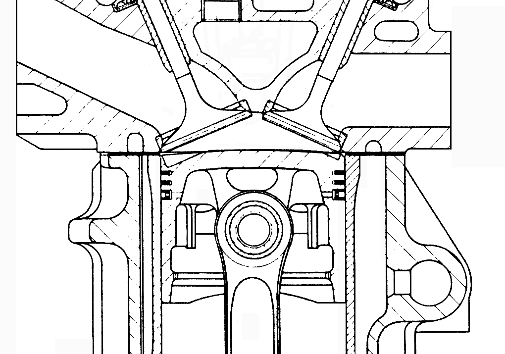

Since you haven't seen a TS in person . . . the combustion chamber is a completely different shape from the Nord engine. A piston with a 10:1 compression ratio is almost flat on top. Here's a cross section.
