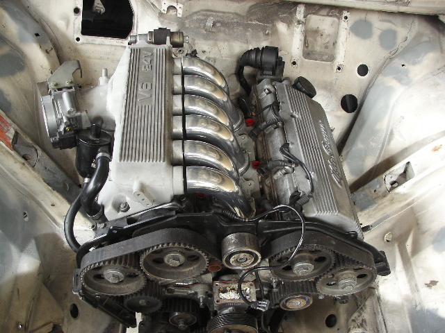

Easiest way is to make your own runners - I think David has posted his up (maybe 2 different versions but do a search and you'll find them).
Use the 164 injector manifold (that way you don't need to build in an injector boss) and whatever size mandrel bends you want. Diameter at the head should be smaller than at the top of the runner ie tapered - it gives higher air speed and better mixing. You can easily die grind the injector manifold to taper from the runner to the port.
I made a set for my 24v using laser cut flanges and 45mm ID tube. I only had to give the injector manifold a light tickle with the die grinder to match them.
- Engine Test Fit 2
- 23-07-06 015.jpg (188.81 KiB) Viewed 10551 times
- Engine Test Fit 1
- 23-07-06 007.jpg (236.95 KiB) Viewed 10549 times

daniel very nice job you have done there but for those who want to keep it standard and i actually think easier aswell then machining them out is by far the best and budget wise choice for similar results to going out and making complete new ones. best bang for buck imho. having said that yours do look good and if i was building a show car i would chrome those babies for all to see. lol

When I did up my 2.5 about 8-10 years ago, I used a die grinder to open out the standard runners. I'm not sure I managed to get them out to 39mm cause I was afraid of cutting through. It was time consuming but definitely cheaper than making new ones.
The ones I made for the 24v are HPC coated not chromed but if I did it again I'd do the whole lot in stainless and polish it because it would probably be cheaper than HPC.
Nice work Daniel,
Is that a 24V from a GTV6/166?
If it is i'm keen to find out the issues with fitting?
