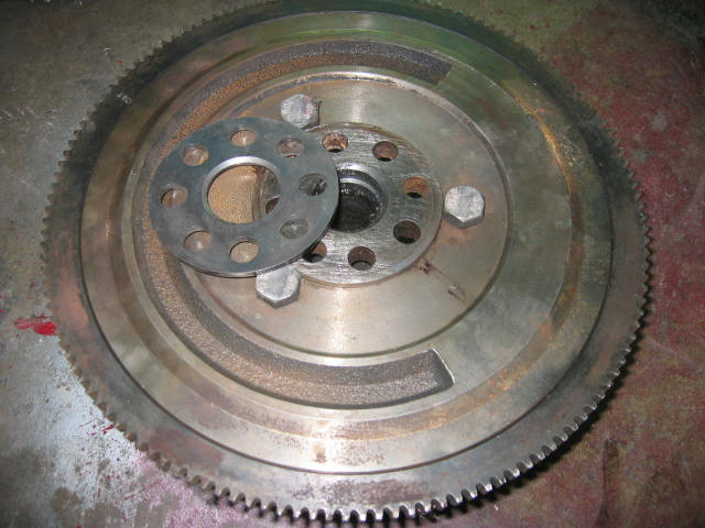

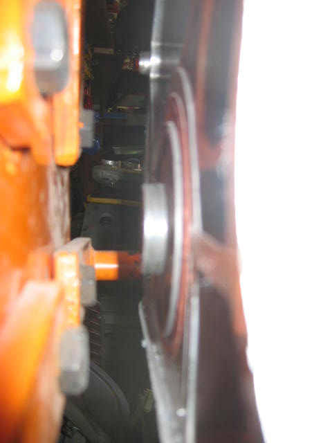

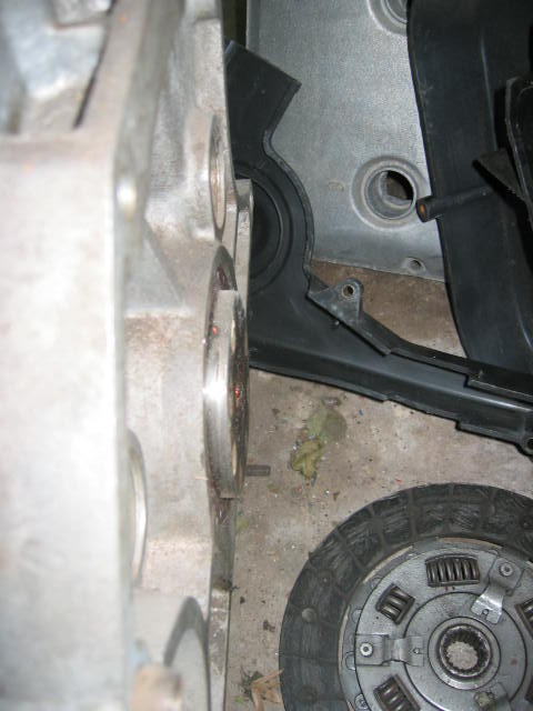

The crank on the 2.5 12v motor protrudes +- 7mm while the crank on the 24v motor protrudes 3mm hence the need for a 4mm spacer if you are using the 2.5 flywheel(re balanced ofcourse) and you want the starter to engage in the exact same place(also using same 2.5 bell housing). Took pics today to avoid any confusion.

Side view of back of 2.5 12v motor showing crank protrusion.
Side view of GTA crank in 164 block. Bit blurry but you can still see the crank protrusion.
Spacer

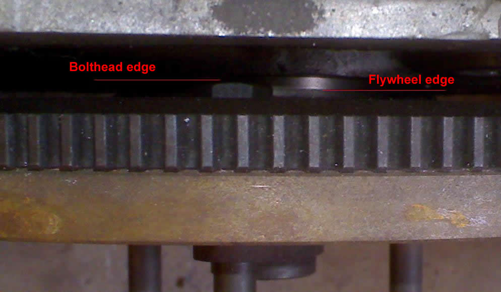

However I was in the garage yesterday and found an interesting thing.
The 2.5 flywheel differs from the 3.0 12V flywheel.
Actually the crank differs also. i.e. the 3.0 12V crank looks like the 3.0 24V in terms of protrusion.
That means that the 3.0 12V flywheel is thicker than the 2.5 flywheel where the bolted connection is and therefore I don't need a spacer.

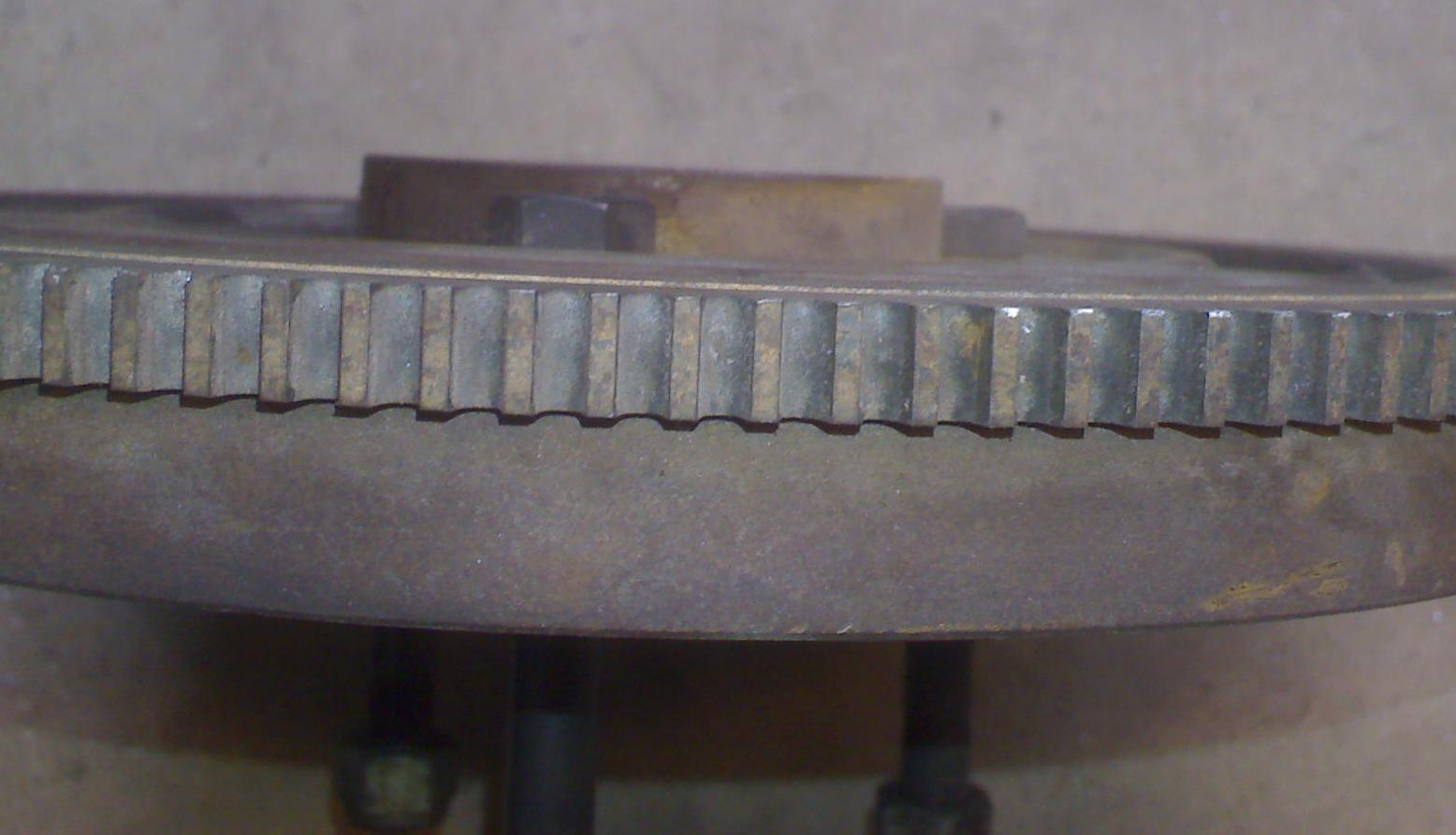

I took a couple of pictures with the mobile to show you, unfortunately its poor quality but you may be able to see the difference if you look at the boltheads compared with the flywheel edge.
2.5 flywheel
2.5 flywheel

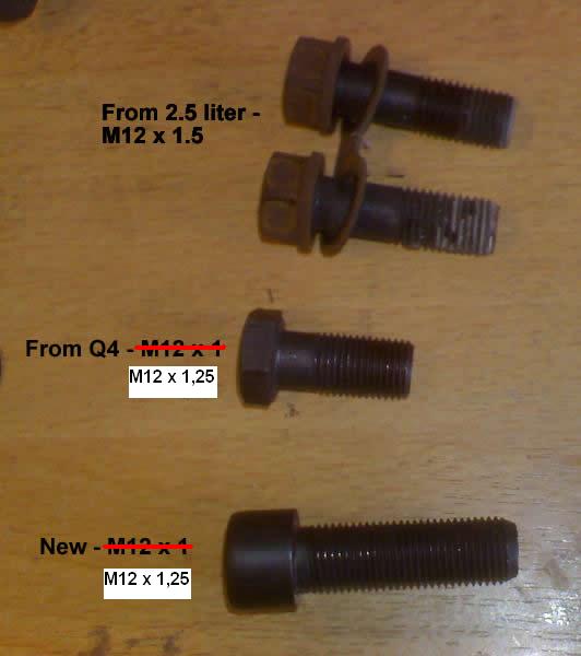

Daniel wrote:
The only thing I had to do was to get new bolts to the flywheel since its a different thread in the Q4 crank than in the 12V engines
Now you have me worried - I know that the 12v engines have M12x1.5 thread, what does the 24v have?
I am going with the 2.5 bell housing and retaining the standard 24v flywheel (somewhat modified) and starter motor. My flywheel mod requires me to use bolts 15mm longer than the standard 24v ones. I hope I can get the thread in a grade 10.9 or better.
Took a pic on the flywheel bolts.
Edit: Realized that it was M12 x 1.25 so I changed the info in the pic. :oops:

I measured my 24v flywheel bolts - they are too short for what I want but they are definitely M12x1.25, not M12x1.5 (I measured the 2.5 12v engine that I have pulled out)

Daniel wrote:I measured my 24v flywheel bolts - they are too short for what I want but they are definitely M12x1.25, not M12x1.5 (I measured the 2.5 12v engine that I have pulled out)
Strange, I'm pretty sure my 24V bolts are M12x1.0 (see my previous posted pic).
However I will double check that at the garage tomorrow.
