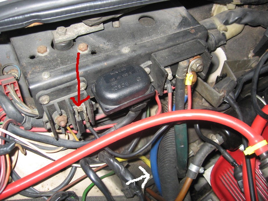

Photo below:
red arrow: starter solenoid hook up is a weak ground..shoud this be?
White arrow: new battery cable

got to be a short somewhere.......I will start looking near starter and bat cable next.
