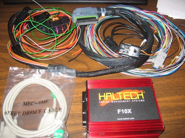

Just got me Haltech today... :D
Going to set it up with regular 3.0 in the car and get some base maps before putting in the new 3.0 for breakin....
f10x with flying lead

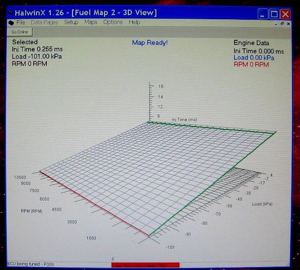

Halwin 3D injector map baseline:

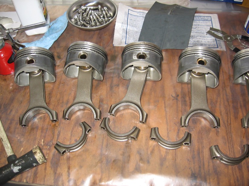

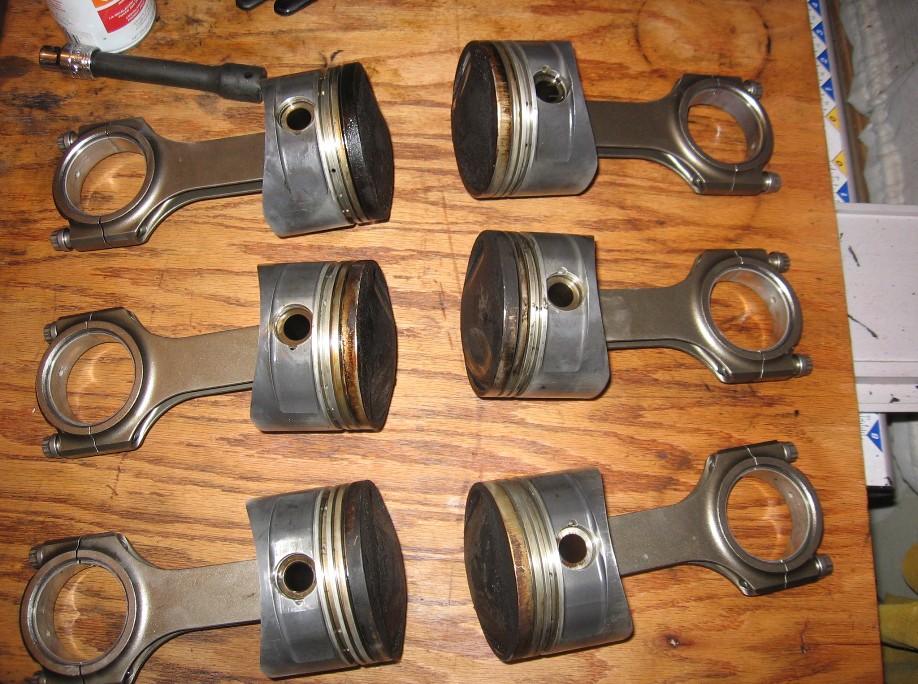

carillo rods and venolia pistons almost ready to go back in

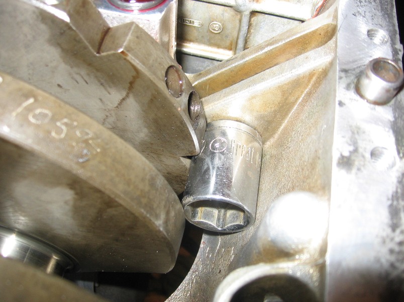

22mm socket pins the crank making crank nut removal easy

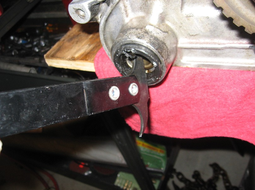

seal prying tool..be sure you don't gouge the aluminum housing..pry top down so if you make a gouge, it is less likely to leak

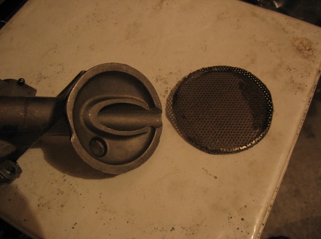

pry off screen and realy get at the dirt in the oil pump..and then put screen back on

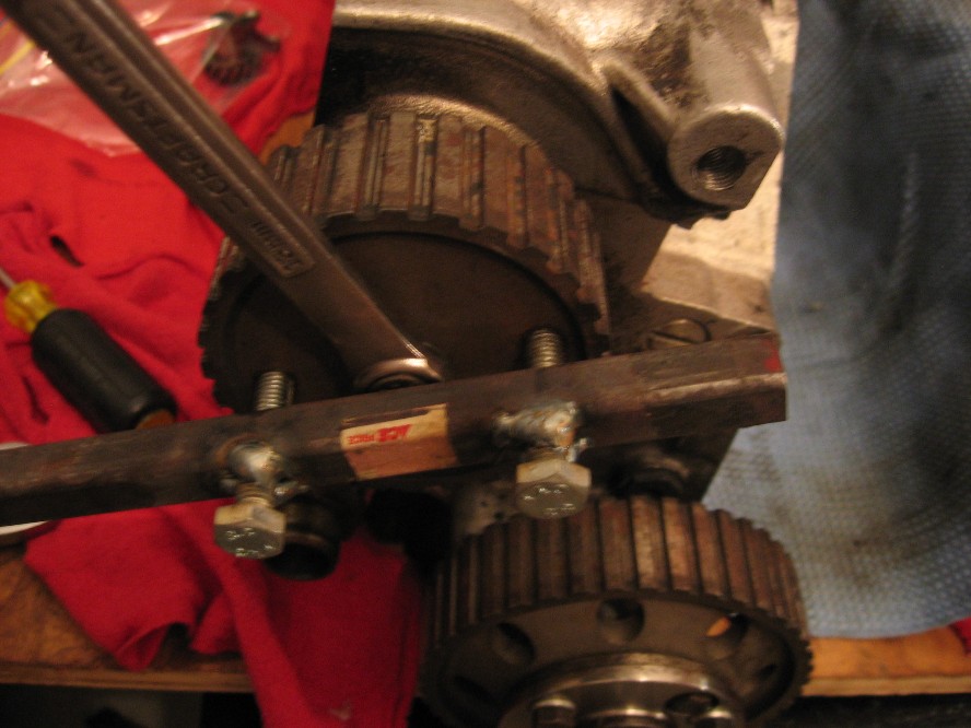

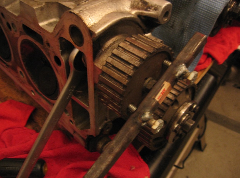

make sure the tool bolts are long enough to get a wrench behing it so you can remove pully bolt, too.
made this tool for timing gear removal

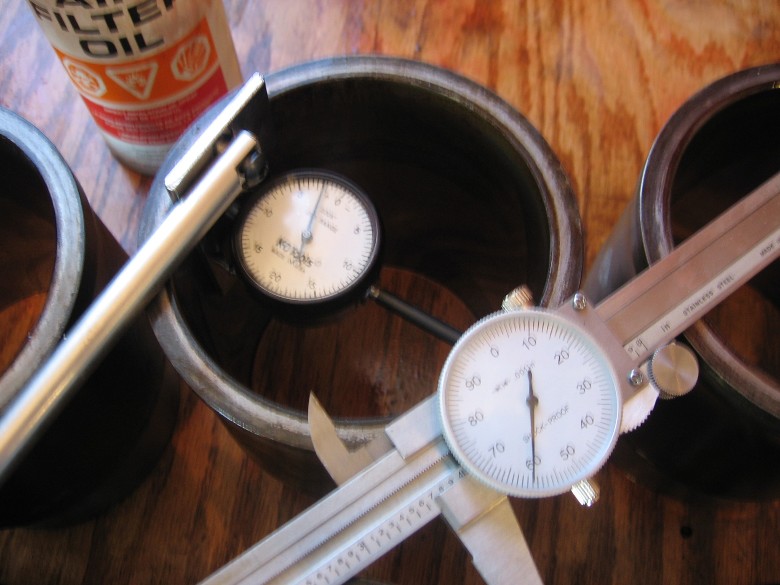

bore guage (KD tools) and cen-tech guess'o'matic slide guage. Bores all on tight side of Cylinder "B" diameters..these were the best 6 out of 12

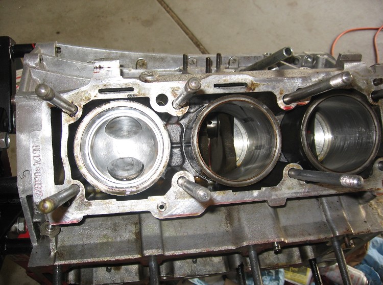

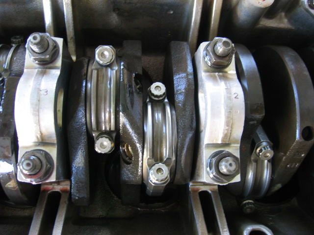

I like to work rear to front starting at #3 cylinder....rod shoulders face front only for three out of six cylinders

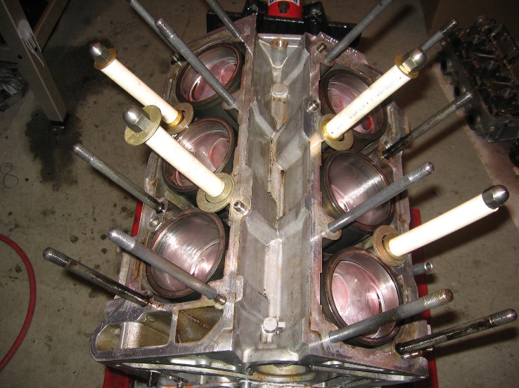

liners and pistons all in

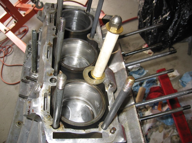

home made liner hold down tool

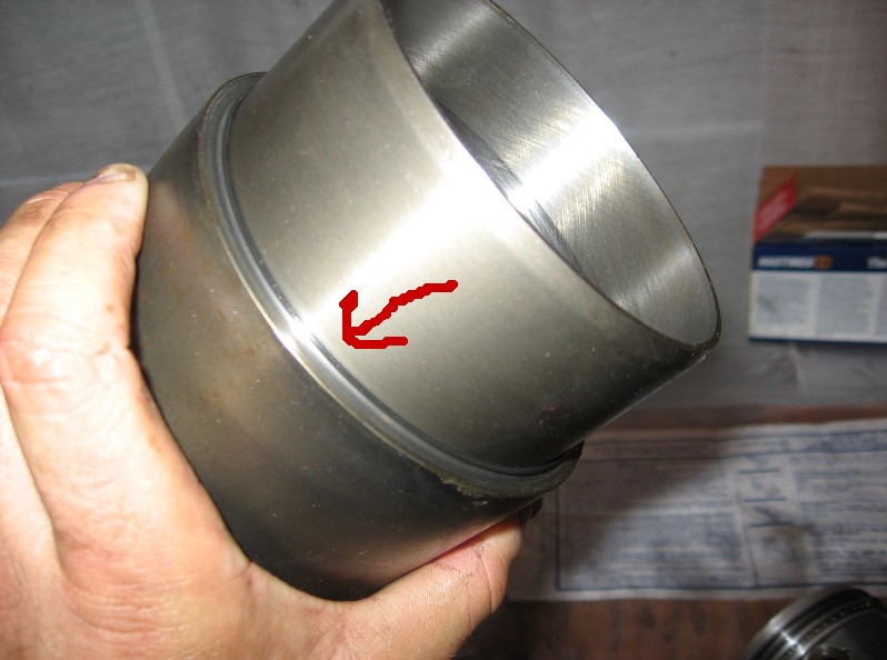

make sure liner seal in not twisted/rolled

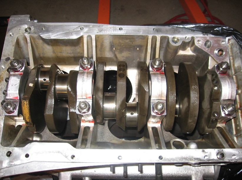

bottom end..
bottom end..

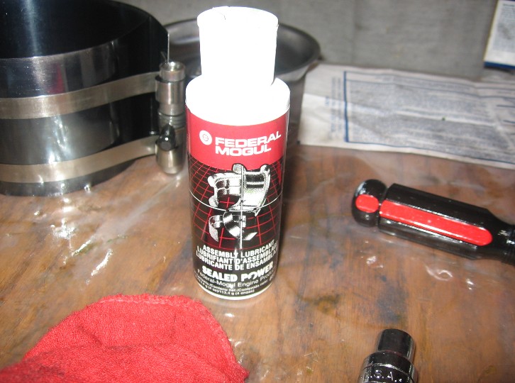

Federal Mogul makes a realy thick stick lube for engine assembly..not a grease..but stays in place well..easy to work with.

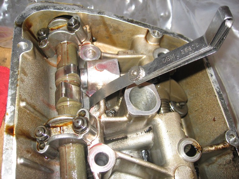

Don't forget to measure cam clearance BEFORE taking apart..

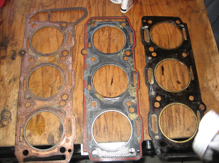

Here is something interesting:
Three variations of head gaskets not including the original three ring circus. The 'copper' coated one came off easily as did the black one. The Guarnit auto ones (middle) always stick and are a pain in the ass to get off..
I don't know who makes the others, but I think the black one is Reinz
I would like to get my hands on a set of the copper or the Reinz so if anyone knows where..let me know

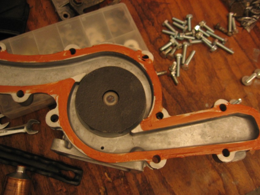

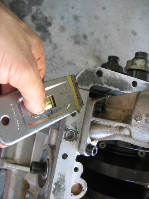

I use a very fine flat file to clean the faces of the block and covers, followed by a light sanding with 400 grit..clean out all the little pieces with aluminum carb cleaner and air gun dry
Some gasket material will dissolve aluminum over time. I use permatex orange and have not hand any erosion issues

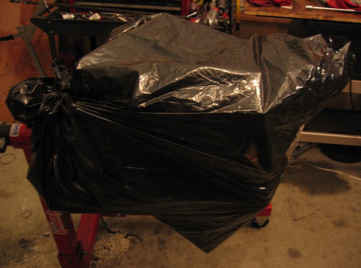

bag it to keep everything out

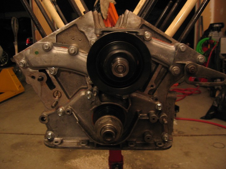

finished front covers and new pump<br /><br />TIP: drive the seal onto the cover BEFORE putting the cover on

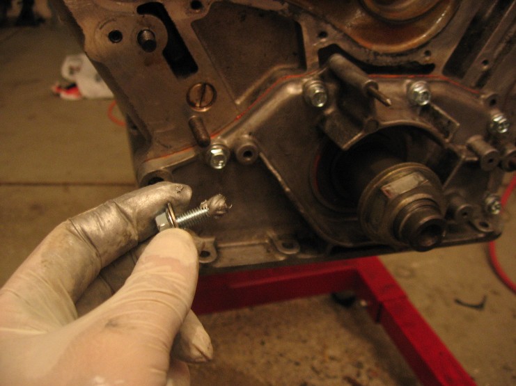

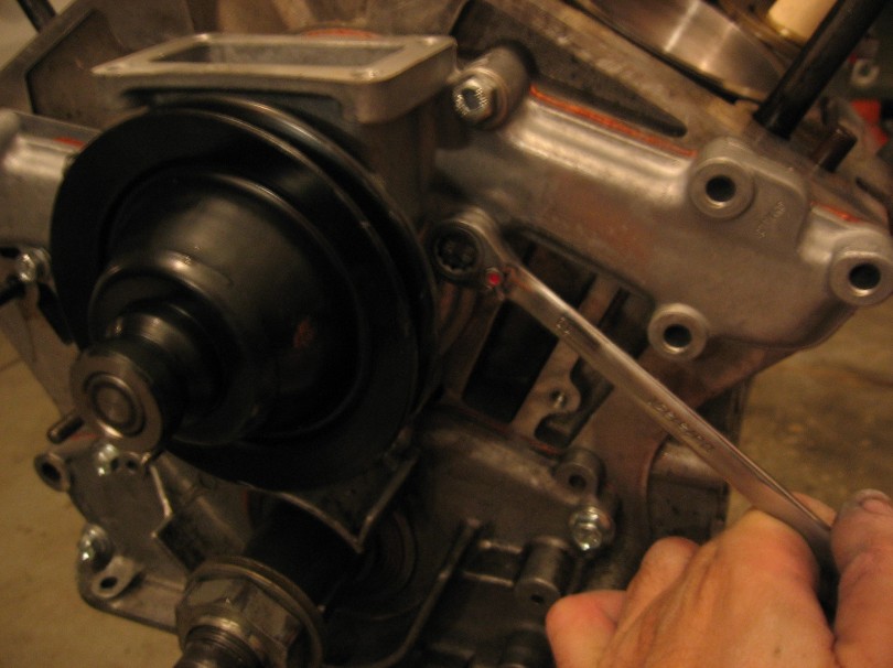

10mm ratchet wrench makes behind pump bolts easy to do
very thin layer permatex on both sides of gasket..never had a leak

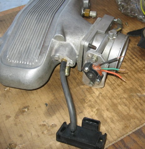

Worked on some of the things needed for the Haltech. This included plugging unnecessary holes in the thermostat housing and tapping a new hole in intake manifold for air temp sensor. Basically, the Haltech is practically made for this engine (Bosch system) so that the throttle position sensor and H2O temp sensor fit in stock locations with little work.
Air temp sensor fits on passenger side of intake manifold in a 'blank' spot perfectly.....
Just need to make a small alu mounting plate for TPS...
HAltech hookup is pretty simple:...4 sensors...6 injectors....power ....ground...fan control...fuel pump control...O2 sensor
Just bought a bosch wideband O2 sensor for 60$ so will eventuall switch out older O2 sensor

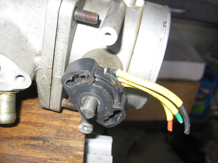

TPS fits throttle shaft, just have to make a small mounting plate...
fits like a glove...

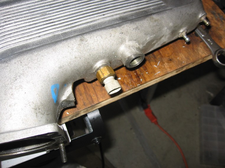

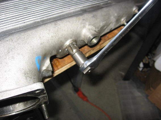

NPT tap for air temp sensor...

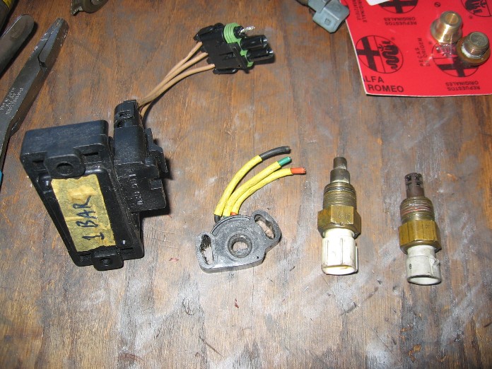

Four sensors for HAltech: Air temp, engine water temp, 1 Bar Map, and TPS (these were off my old Haltech E6S)
Three of the four haltech sensors mounted.
Use the blank for the air temp sensor.
Use the cold start injector hole for vac to 1 bar map sensor and plug two screw holes.
Made plate for TPS from spare aluminum heat sink (the thing coil and ign unit were mounted to). Any 0-10K (or near)three wire pot will work.
Sensors are standard GM stuff from the late 90's. Don't be fooled by high priced Haltech stuff. Just bought a spare air temp and water temp sensor for 40$ with connectors. TPS sensor is a little different and I have not been able to find the same casing that they supply. Haltech TPS is about 65$.
So, most of the work is done on the intake manifold and it can all be easily reversed if you had to take the unit out for some reason.
I plan to leave the cold start air valve and hoses in place. Haltech will allow cold start enrichment so no need for cold start injector.

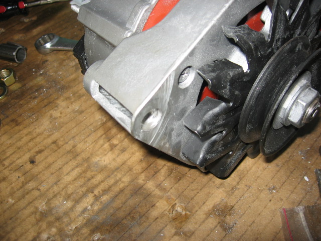

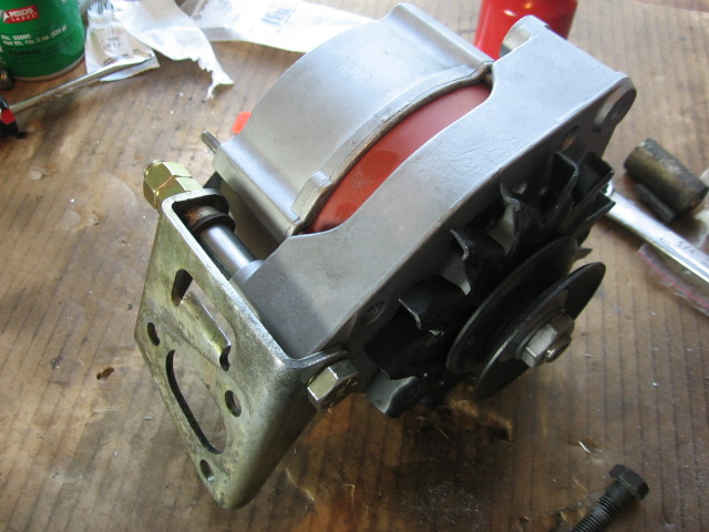

Tired of that wimpy 60 amp alternator? Here is BMW 90 amp conversion:
Get yourself a late 80's BMW alternator (like for the 325: Bosch # 0 120 469 777 14v/90a) These can be had rebuilt for about 90$. Get a rebuilt one because it will cost you about 60$ in bearings, copper rings, and regulator...plus it has already been tested...
anyway, conversion is simple. You can do it your own way too.

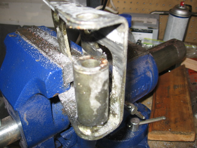

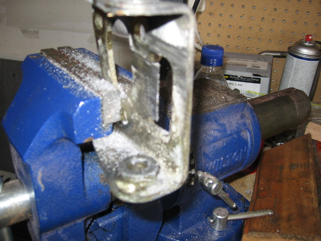

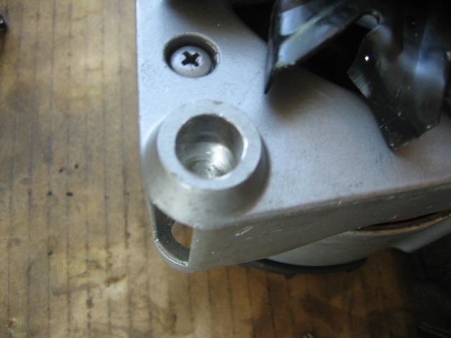

I used 1/2 inch drill bit as big bolts are easy to get in 1/2 inch. Drill lower alt. mount all the way through at 1/2inch. then grind off front aluminum spacer on front of alt. housing until flush with rest of housing face.
Cut off spacer on Alfa alt. mount as in the pics...or you can cut less off. I did it this way so I can use other alternators and not have to re-cut the mount.
I used steel pipe as a new spacer and a washer to take up any play.
Distance from center radius of belt pulley now lines up with center radius of crank pulley. Wiring is the same...one to batt and one to alt light (B+ and D+). Bosch alts come with easy to exchange volt regulators on back...however, as far as I know, you can't easily make a 60 amp alt into a 90 amp alt. Also uses a 2.2 uFd 100v cap on back..another easy change if needed...
Enjoy 90 amps and lights that don't fade.....
all done...except for grinding top mount flush

cut longitudinal weld on back of spacer and cut outspacer...i used a sawsall w/metal blade for all cuts
grind flush....
grind flush....
drill all the way through with 1/2 in drill

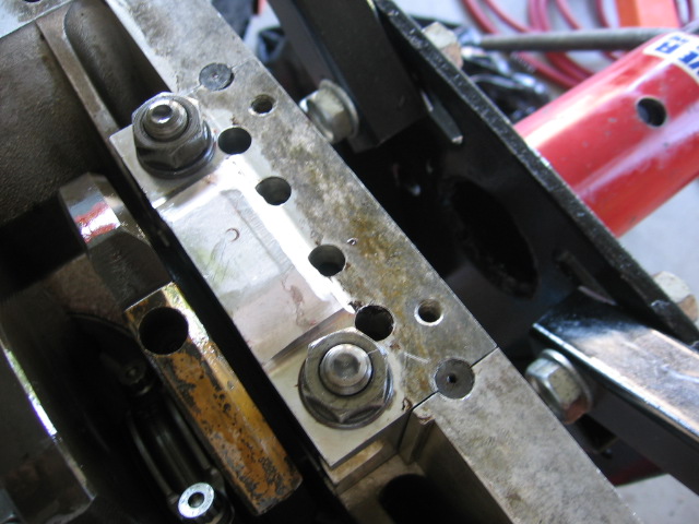

I put the rear seal in before torquing the cap nuts all the way down. Makes it much easier. I also add a VERY thin layer of permatex around the outer edge of seal. Never had a leak back here with three rebuilds...

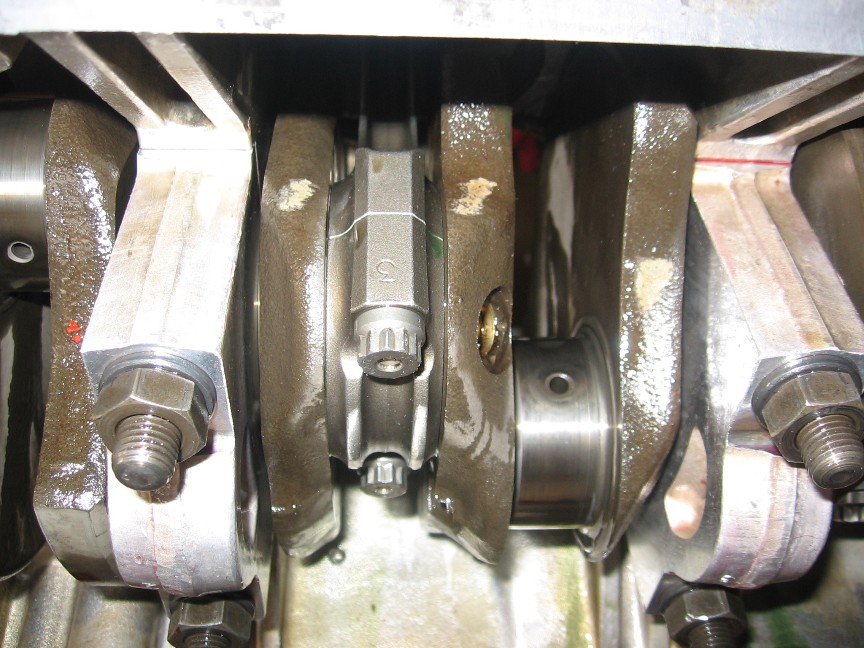

Be sure larger con rod shoulder face oppositely for each cylinder pair (ex: 4 faces front, 1 faces rear)

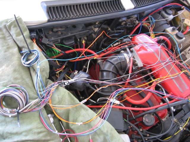

Haltech Install

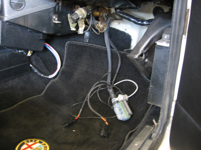

Ran harness through AC gasket on firewall..perfect fit
wires over engine will be used, others not needed for this project
Haltech in...started right up.
The Hal'win' computer program VERY easy to use..you can open several maps at one time. Also, there is a guage face window which is real easy to check everything at a glance...
Running a 'little' rich right now.......
