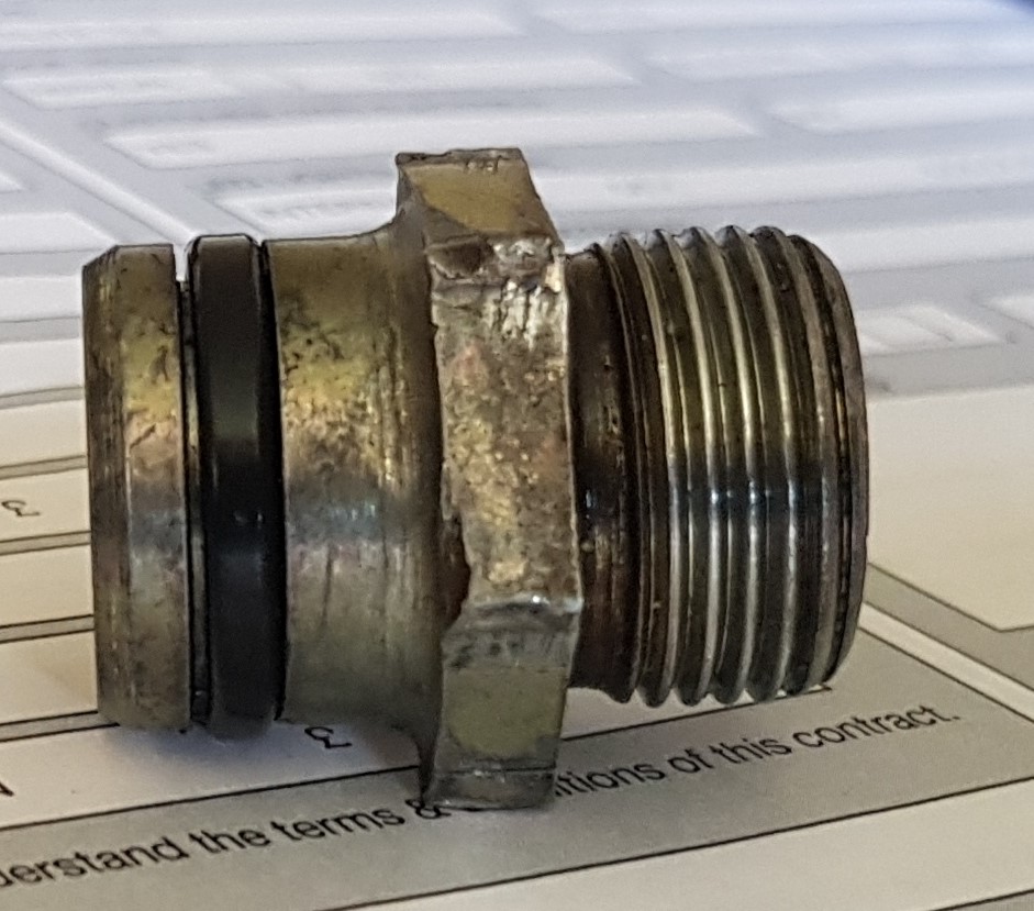

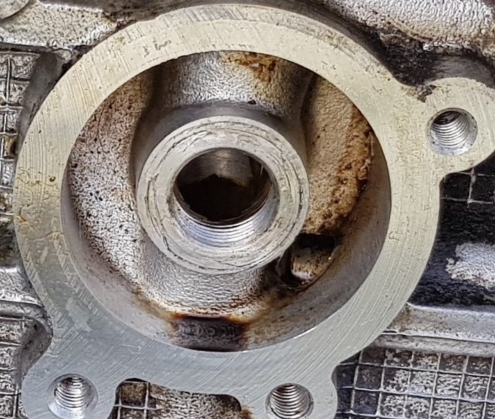

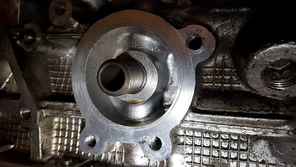

Hi all
I have removed the oil filter heat exchanger from the 164 engine and the fitting which is screwed into the block
The picture below shows the screw which is threaded into the block and has the o ring
Where the screw fits to the block is recessed a few mm from the facing where the adaptor fits
I noticed earlier that kev has used a threaded tube which I presume is the same thread along its length and matches the one I removed
my question is does the gtv6 oil filter have a diffent thread to the 164
The reason I ask this is I tried to fit the screw to the 164 oil filter and it doesn't fit so I presume when kev fitted the threaded tube to the block then he must have used a different oil filter
is this correct

You seem to need the standard 164 12V oil filter attachment. Ideally, you can find a part number and order this part. I would expect that this item is difficult to remove without damaging it.
