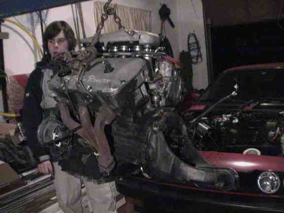

No Greg and Peter I made no mention of forced induction in my initial post.First I'm going to rebuild and then I'll dyno it to compare to my recent results.If I can pull 140 Whp out of her then I might be satisfied short-term if not then I'll consider going with a SC.Engine came out last night - not a bad job but man do I wish I had a heated garage to clean this thing up.I'm going to go through a lot of degreaser before I'm done.

Good job getting the engine out, now you are commited!

Greg yes I'm now committed.Talk and supposition replaced by actions ! I am very hesitant to shave the heads to change CR.because I don't want to end up having to play with the cam timing-offset keys etc.I'm reasonably confident that I can get a good bump in horsepower just by taking the steps you have outlined.I looked into the exhaust ports last night and am very surprised that my engine has been performing as well as it has (130Whp.).The back side of the exhaust valves are a mess.Looks like oil leaking by the seals has been baked on to the stems and formed a gooey mess.Glad I decided to open her up.
