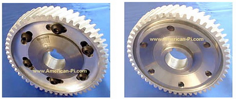

Don't pay for adjustable gears, make your own by converting the std ones. I have a set I'm going to modify. The only cost will be the machine shop and the pantograph machine to scribe the lines and numbers. I haven't asked for cost yet, but it sure beats buying ready-made ones.... :shock:

No, the 4 original ones are modified. First, a round plate is precision fit inside the wheel (with a hole in the middle for the center boss). Then the inside part is cut off in the lathe, right in the middle of the 6 or 8 round holes. The outer and inner parts are fixed to the new plate with bolts. The plate has slots to allow rotation. You can also make 6 or 8 holes in the plate and paint it so it looks better. The hard part is scribing degree marks and this is done on a pantograph machine.
I must get around to make a set of these. Gotta ask how much the machine shop wants for the job and markings. The attached pic will clearly show how an adjustable gear is made. Inner/outer parts are retained and a plate is made to connect them and fit precisely inside the outer part.
